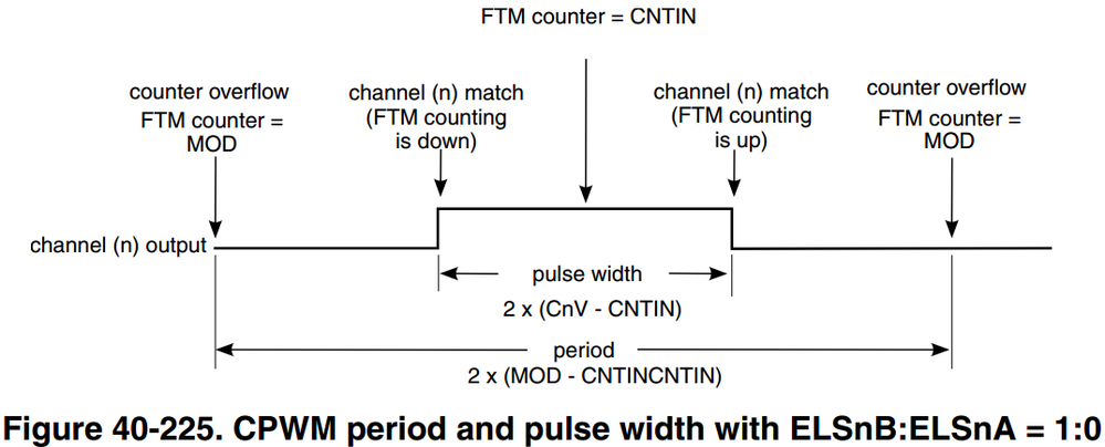

Hi all.
I'm beginner in Kinetis K64.
I have some questions about FTM (PWM) of Kinetis K64.
Q1
There are 4 FTMs (PWM) on Kinetis K64 (FTM0..FTM3) and each FTM has 8 channels.
Can each channel generate different clock signals?
(ex. FTM3 ch0=10Hz, FTM3 ch1=20Hz, FTM3 ch2=30Hz...)
Q2
If answer of Q1 is yes, how should I control registers to generate different clock signals?
Kiyoshi
2,105 Views
EarlOrlando
Senior Contributor II
Hello Kiyoshi,
Each FTM instance [0:3] is capable to generate a different frequency but each channel for an instance is capable to generate a different duty cycle with the same frequency. The duty cycle is changed with the register FTMx_CnV as is mentioned in the section 40.4.6 and 40.4.7 in the Reference Manual​.
Earl Orlando.

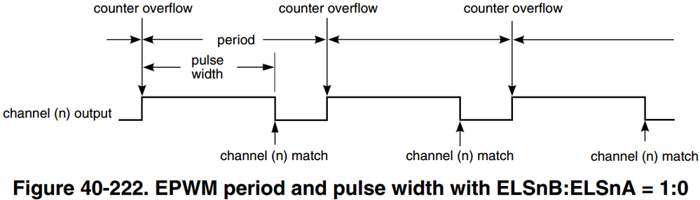

EarlOrlando
Hello Kiyoshi,
You can use the different FTM instances and additionally to use two different frequencies (ratio 2:1) you can read about the differences in the Center-Aligned PWM (CPWM) and the Edge-Aligned PWM (EPWM) modes. The Center-Aligned PWM has the double of the Edge-Aligned PWM period.
Please let me know if this information is useful or if I can do anything else for you.
Earl.
