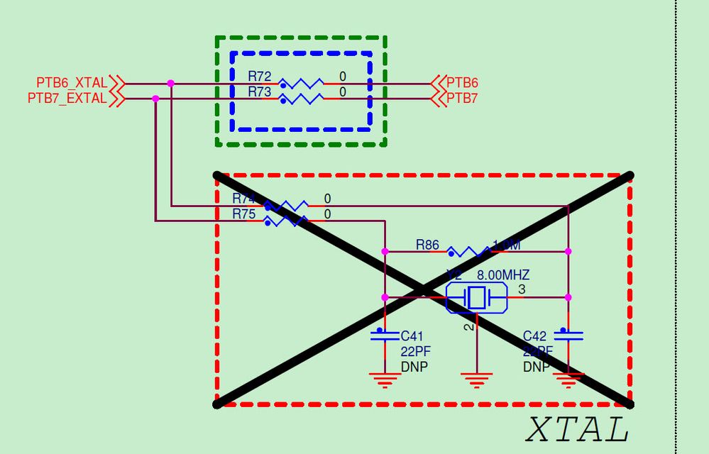

I am working on TRK-KEA64 trying to initialize oscillator to generate 40 MHz as core (system) clock and 20 MHz as Bus clock.
/* FLL Enabled with External clock */
/* High range & gain; select osc */
/* OSCEN =1 ; OSC module enabled */
/* OSCSTEN = 0; OSC clock disabled in stop mode */
/* OSCOS = 1; OSC clock source is selected */
/* RANGE = 1; High freq range of 4-24 MHz */
/* HGO = 1; High-gain mode */
OSC_CR = 0x96;
/* Wait until oscillator is ready*/
while ((OSC_CR & OSC_CR_OSCINIT_MASK) == 0);
Code does not come out from the while loop due to the non-initialization of the oscillator.
Could you help please ?

mohammedaboelna
Hello Kerry,
I put a similar crystal (Y1) which is specific to OpenSDA and now the crystal oscillator is working very good.
Thank you for your support

I did a prompt test on the external oscillator as follows;
I monitored the crystal pins themselves using oscilloscope to make sure that the crystal is not working.
I doubt that there should be a specific type of crystals that could work with TRK-KEA 64.
I do not know do you agree with me ?
I am not pretty worried. the point is blocking so that i am a little bit worried !! :smileyhappy:

kerryzhou
I find in the TRK-KEA128, it doesn't solder C42 and C41, maybe you also can remove your C42 and C41, then try again.
Kerry

kerryzhou
Hello Mohammed Aboelnasr,
    1. let's talk the hardware about hte OSC
    From the TRK-KEA64 board schematic, you can find this circuit:
You need to solder R74, R75 =0, r86=1M, Y2 8Mhz crystal, C41 and C42.
2. Software
   You need to enable the OSC, then the external OSC circuit can oscillating.
   I already help you create a CW PE project, which is already configured with 8M external crystal, you can download the code to your TRK-KEA64 board.
  Then reset the board, and use the oscilloscope to check the PTB6_XTAL and PTB7_EXTAL, whether it is oscillating?
  If yes, it means your hardware is working, otherwise, you still need to check your osc external circuit.
  Please use my attached project and test it on your side.
After you test it, if you still have problem, please tell me the detail test result on your side.
Kerry
