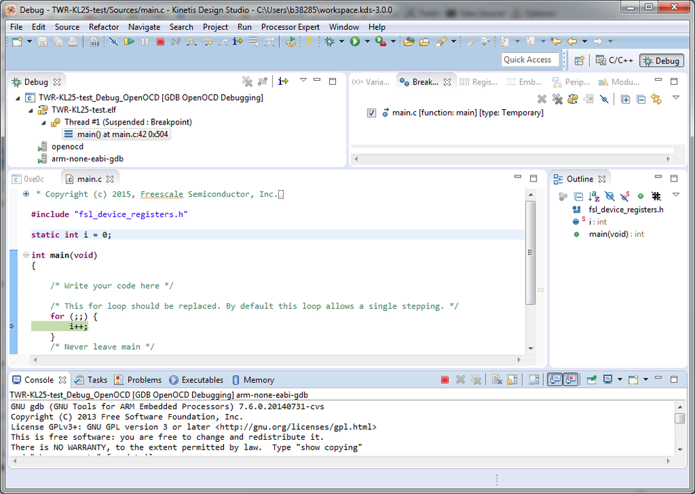

Carlos_Mendoza
Hi Demos,
Thanks for the information.
I have done some tests using the k20dx128_kl25z_if_mbed.bin file and it is working correctly on my side, I tested it on KDS 3.0.0 using the K20DX128 MCU on the FRDM-K64F board to program and debug the KL25Z128 MCU on the TWR-KL25Z48M board.
Once I load the k20dx128_kl25z_if_mbed.bin file to the K20DX128 MCU it is correctly recognized by the computer:
And I'm able to flash and debug the KL25Z128 MCU:
My guess is that there might be something wrong with the board? can you post your schematics so I can review them?
Hope it helps!

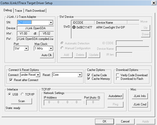

demosdoumenis
Hello Carlos and thank you so much for the comprehensive response!
I also can "see" both the host and the target chips on Keil uvision under the CMSIS-DAP debugger, so the files and the card must be OK. My board can enter "bootloader" mode with the reset button presses, otherwise it appears as "mbed" with an mbed serial port present.

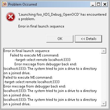

demosdoumenis
Under Freescale KDS the OpenOCD terminates with the following error (under windows 7 64-bit)
5,924件の閲覧回数

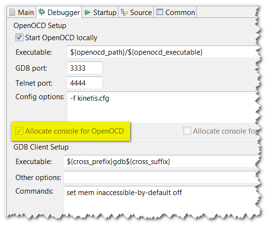

UK_CF_FAE
That 'The system tried to join a drive....' error message can come from there being no console allocated to OpenOCD. Do you have it checked in your Debug Configuration? This is KDS 3.0.0:
It seemed to work OK for Carlos, and so I believe that the binary image you've created is correct. It must be something connected with the OpenOCD configuration on your PC, or the settings in KDS. Actually, since you have similar behaviour in KDS and from the command line, it is more likely to be OpenOCD settings.
Do you get the same behaviour on another PC?

demosdoumenis
Hello Mark,
Thanks for your detailed reply. I have been testing KDS on different PCs (and a Mac) with no success.
If you are sure it is an installation problem I might try re-installing everything.
Incidentally, the "Allocate concole for OpenOCD" tickbox is greyed and ticked, so I cannot change it on KDS 3.0.0

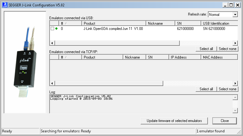

demosdoumenis
Hello Anthony,
Due to this firmware problem, we are indeed using an FRDM-KL25Z with the SEGGER JLink app to act as a programmer connected via a 10-pin SWD flat cable to our target board. The FRDM-KL25Z enumerates perfectly (see pictures) under JLink Configurator and KEIL (with J11 shorted, seeing its on-board KL25 chip)
However, when the same firmware is loaded on our custom board, it does not get recognised (see below).
but the FRDM-KL25Z connected via a flat cable to our board is recognised (see below, J11 open-circuited, seeing our custom board programmer chip) and we can flash the .axf file mentioned in OpenSDAv2
Our board as far as the OpenSDA circuit is concerned, is a direct replica of the FRDM-KL25Z.

demosdoumenis
Hello Anthony,
We have been looking closely at your very concise instructions and we could only "see" processors using the JLink v2 (not v2.1) app. Using an FRDM-K20D50M as a host, our own K20 MCU can be recognised. However the same K20 MCU as host cannot recognise our own KL25 MCU on the same custom board. We did a lot of tests to identify the behaviour (hence the delay in responding) and the SDA_DATA signal going from our host to our target was always held high ('1'), even though the SDA_DATA was OK. On closer inspection there was a short circuit on our SDA_DATA line buffer between input and output. Fixing this on the board, all functionality was restored. Our board can now be programmed using KDS, or CW.
Cannot thank you enough as following your detailed instructions we could identify the hardware bug.
P.S. This issue can be considered closed.

BlackNight
Yes, it is not possible to deallocate that option in OpenOCD (and I don't know why).
