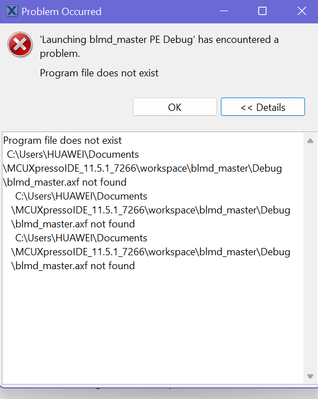

Hi @Robin_Shen,
I checked my device and it is in a bricked state. After, I followed the steps in the link you posted.
This time I received a message that .axf file does not exist. Am I doing something wrong with the steps?

ErichStyger
Specialist I
Does that .axf file exist? If it does not exist, then you might have missed to build it (hammer icon in the toolbar) maybe? Or your build has not succeeded and you have errors in the build? Check the console output or the 'Problems' view.

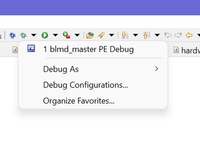

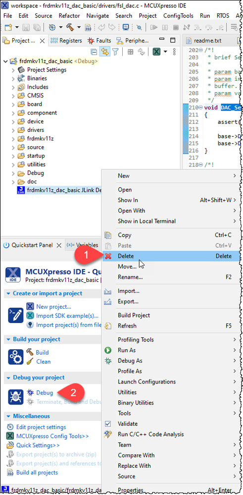

After you followed the steps in the link, can you see the device mounted asMAINTENANCE?
I can see the PEMicro blmd_master PE Debug in your image, would you please delete it and then click debug again?

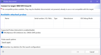

nxp_user123
I am using MKV11Z128 to reprogram TWR-KE18F. Devices are connected via j link
I did what you said. But I couldn't see available probes. What should I do?
@Robin_Shen , @ErichStyger
5,775 Views

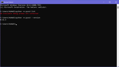

as you are using pyOCD: this is not supported, at least not out of the box. You have to consult the pyOCD group: https://pyocd.io/
5,760 Views

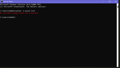

nxp_user123
Thanks for your advice. I tried what you said but the probes were not found. @ErichStyger
Here is my system.

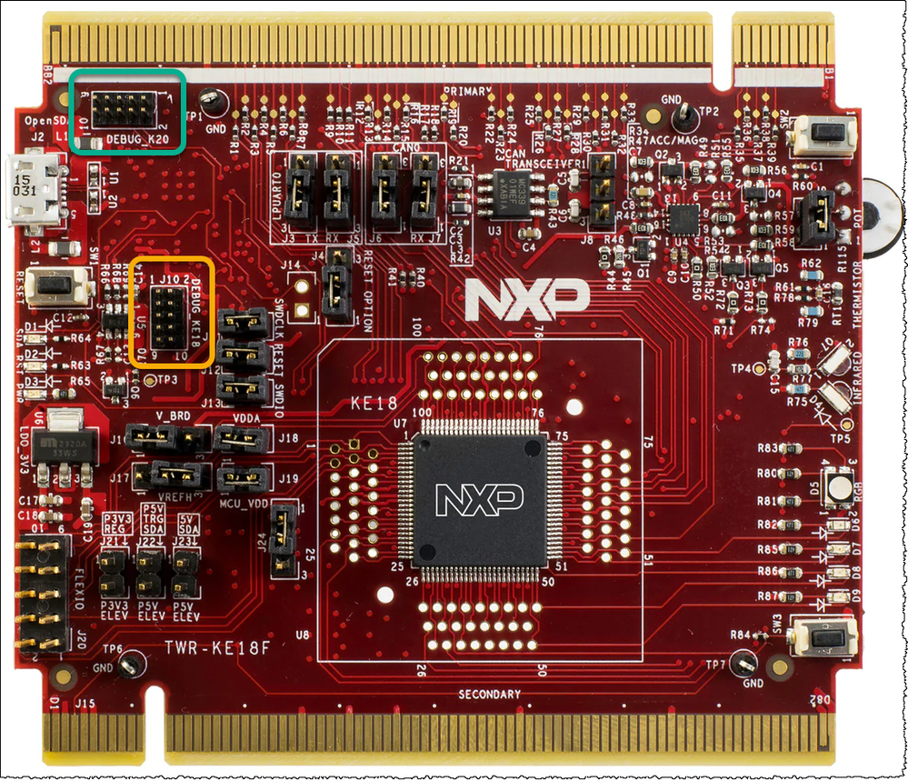

Seems that you connect to the wrong connector(J10). J1 is used to program K20 OpenSDA.

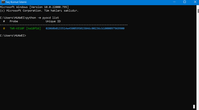

nxp_user123
I found the Unique ID number. Which command should I use at the command line?

nxp_user123
The device manager shows the port but still cannot debug it. I used pyocd flash command in the command line but it said that KE18F16 is in secure state. How can I disable the secure state?
