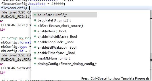

I tried to specify the option as suggested by you:
But as you can see, the option is simply not available, putting it in manually results in a compiling error.
Could this be part of an older SDK?

Your totally right, this is not implemented in the SDK for the KW36, please set the MCR.SRXDIS bit after configuring the module, remember that this bit can be written only in Freeze mode because it is blocked by hardware in
other modes.

As I previously mentioned the disableSelfReception field is in the FLEXCAN_GetDefaultConfig(&flexcanConfig) if you call this line after the GetDefaultConfig API you will disable this feature:
flexcanConfig.disableSelfReception = true;
This filed correspond to CAN0->SRXDIS, the messages send by the module will not be listened by itself and if you have the same ID in the TX and RX the communication will be done correctly.
Let me know if this helps you.
