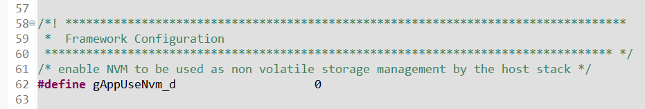

I have tried to transfer data using both Console and UART mode. But not able to send the transfer data from Mobile device to KW36 module with second time connection. This will happens only with the bluetooth version 4.0. With other bluetooth versions (4.1, 4.2, 5.0), it works fine.
How would I know that NVM is enabled or not?
I found in app_preinclude.h file as below:
Is this correct location or anything else for NVM?
Thank you.
9,029 Views
mario_castaneda
Hi Chintan,
I tested using an Andriod Phone Bluetooth 4.0, and it is working. it only works if you are working with the UART mode.
Is this the correct location or anything else for NVM?
Yes, that is the define for the NVM. If it is enabled, the bonding information will be saved in Flash memory, otherwise in RAM.

I have enable "gAppUseNvm_d" macro by setting it as 1. And it stores the bluetooth device information to NVM successfully.
