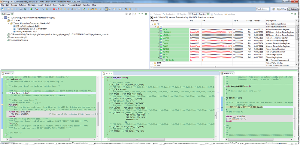

Robin_Shen
Hi James,
I haven't found any obvious problems in your program. Maybe you can attached the whole project after zip it. So that we can test it directly.
You can test the attached project generated by Processor Expert with KDS3.2. It can always run into the PE_ISR(PIT_isr).
During debug, can you observe the value of PIT_CVAL1 decrease?
Robin
