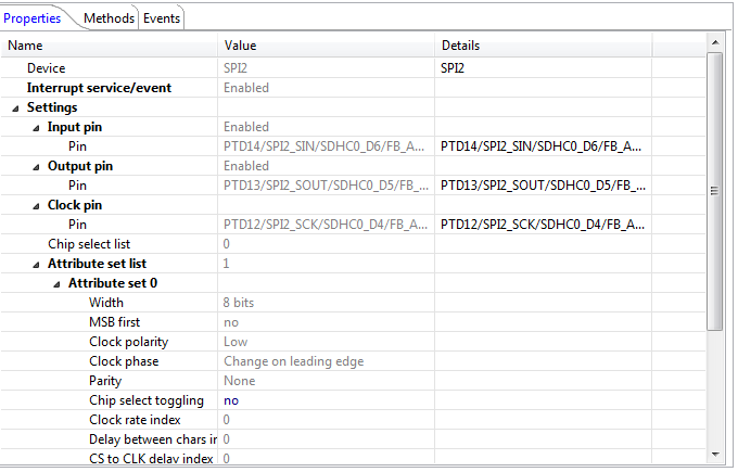

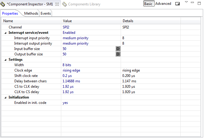

There is no chipselect option in the SynchroMaster Component. It uses Serial Master LDD Component internally in which the chipselect is set to 0. Does anyone know how to enable and set pin for chipselect in the SynchroMaster component?
Thank you,
Karthik
     This is SynchroMaster Component Properties                                                                                                              It internally uses LDD SPI Master component in which there is chip select = 0
