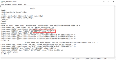

@ErichStyger ok, thank you for the recommendation.  I checked SDA_INFO prior to updating and it was 1.09.  I then updated to PEmicro 1.11, and afterward the SDA_INFO file still said 1.09.  Is this normal?  Whatever firmware is on there seems to take the SEGGER OpenSDA binary just fine.  What kind of OS interference occurs, exactly?

it really should report 1.11:
One easy mistake is: not following the step 6 and 7 as described in
https://mcuoneclipse.com/2014/11/01/illustrated-step-by-step-instructions-updating-the-freescale-fre...
In order to update the bootloader, you have to unpower and normally power the board.
Maybe this is the reason for you?
Erich
6,809 Views
dave408
Senior Contributor II
Erich, you're right. I know what I did wrong. After copying over the bootloader, I repowered the board but skipped a step and held down the reset button again. It's 1.11 now! Thank you for making sure I re-read the instructions more carefully.
