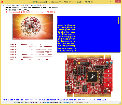

You can get K70 TWR code for the LCD from the uTasker project. It has a GLCD library which allows various basic controls (fonts of different sizes, writing to the display as a console, plus a few drawing and image methods).
Its Kinetis simulator allows the LCD to be simulated too (mini-screenshot below)
Works with TWR-LCD and TWR-LCD-RGB.
Documentation: http://www.utasker.com/docs/uTasker/uTaskerLCD.PDF
Video: https://www.youtube.com/watch?v=AdtRyQ-2IrE (shows Coldfire but is identical for K70)
Mark
K70: http://www.utasker.com/kinetis/TWR-K70F120M.html / http://www.utasker.com/kinetis/EMCRAFT_K70F120M.html
