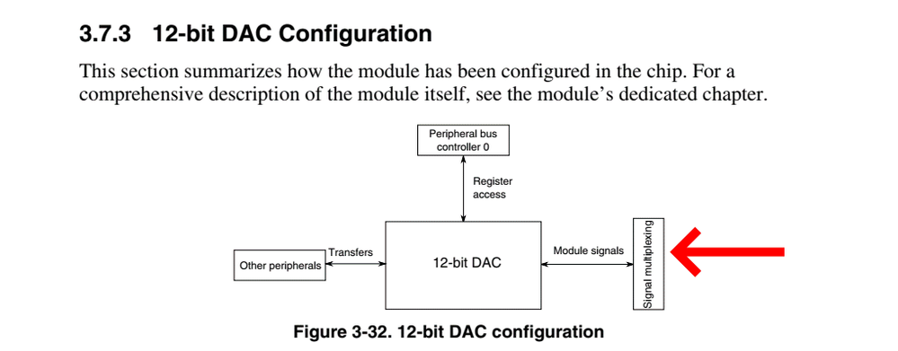

I am using the MK12DN512VLK5 device in my design. I am using the MCUXpresso IDE along with the MCUXpresso SDK.
My application requires configurable analog output voltage for which I am using the 12-bit DAC0 module on this microcontroller. I have followed all the steps mentioned in the DAC example that were provided for the Towerboard TWRK21d50m that uses the MK21DN512 part. I am aware that this is a different part but I have just referred to the example code to get an idea of how to use the MCUXpress SDK API for DAC peripheral.
The issue is that the Pin22, DAC0 out is fixed at 1.5V, the Vref is the Vreference source 2, which is the VDDA pin 17. I checked the voltage level available at this pin, it is 3.3V.
I am not using the 16 word buffer, just want a single value to be converted to an analog voltage level.
The DAC peripheral initialization code is as below:

I also have a few questions:

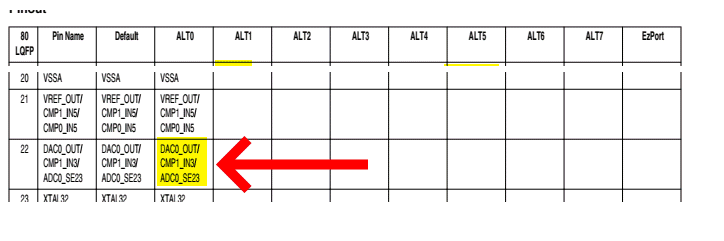

Is pin mux setting required for the pin 22?
I a in doubt because, Pin 22 is not mapped to any port pin. Also the reference manual mentions that it supports only one ALT mode which is also the default mode, i.e. DAC0/CMP/ADC_SE. So according to this description I understand that pin muxing cannot be done as there is no Pin Control register specific to Pin 22, Yet the chip configuration section mentions that the DAC signals need signal multiplexing to be set(in the second image)
Another query is that Pin 22 is labelled for DAC, Comparator as well as ADC, so what configuration is needed to tell the chip that pin 22 is to be connected to the DAC output? I am also using the ADC module in my application, could there be a chance of conflict happening there?

The issue is solved, putting the solution just in case someone else needs a solution. I had left out calling the DAC_Enable(DAC0, true); at the end of the initialization. I was assuming that the DAC_Init() function calls this internally, but saw that is commented and left for the user to call the enable function.
