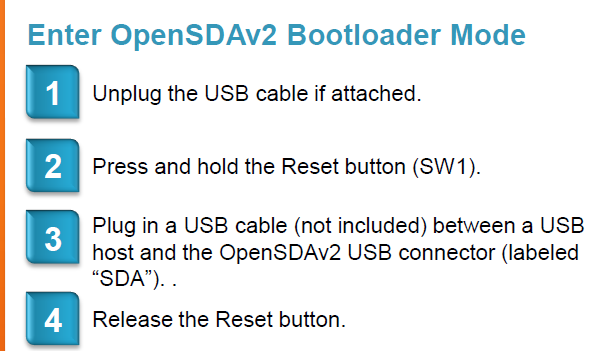

Hello Mona,
Please do as :
(1)
  Copy and past "JLink_OpenSDA_V2.bin:(please see the attachment ) to the BOOTLOADER drirve.
  Unplug the USB cable and plug it in again.
(2) Find one demo code to test .
If still can not work , please send your project to  me , i can test it on my side.
Hope it helps
Alice

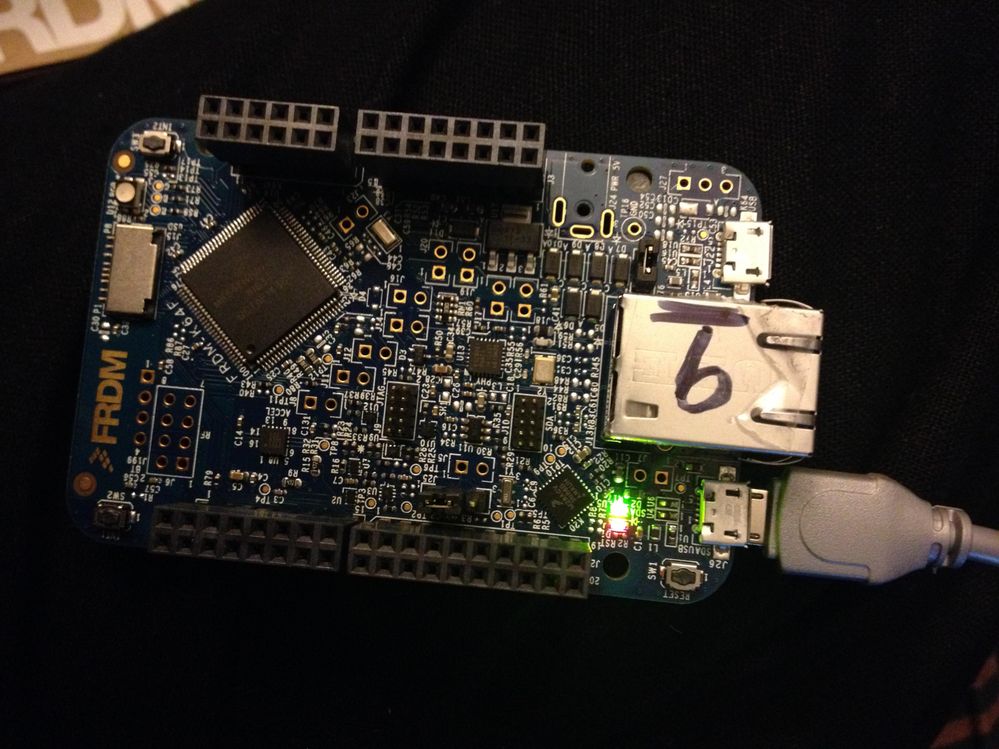

monakhanafriboo
Thank you so much for your replies, I tried all your suggestions, but still no communication. I am using mbed compiler and also KDS. I have attached a picture of my board just to show you how the both lights are on.
4,204 Views
Hello Mona,
Does D1 led light after you only plug the USB ?
If yes,  i have check the Sch about the FRDM-K64 board , this is the rest led, maybe the board is broken.
And do you have other FRDM-K64 board ?
Alice

monakhanafriboo
Hi Jorge and Alice
Thank you so much for your reply, Actually my issue did not solve yet even when I upload new application to it, the 2 red and green lights stayed on, these  2 lights are right cross the reset button. I'm not sure if the board needs any special fixing or it is totally damage.
Looking forward for your advises.
Mona

monakhanafriboo
Hey Alice,
I actually went back to your advice and I follow your steps and now my board is functioning correctly.
Thank you so much.
