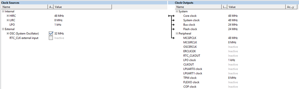

  • Clocks are config as follow:

If you are clocking the TPM with 8MHz it will overflow every 8.19ms, which is its longest interrupt period. If you try to program it with longer values it will result in shorted ones (due to the overflow).
The TPM also has a pre-scaler that can increase the time delay up to x128, and so maximum 1.048s

I'm glad to notice you that the timer is working perfectly. I configure it as shown below
 tpm_config_t tpm2Config;
 TPM_GetDefaultConfig(&tpm2Config);
 tpm2Config.prescale = kTPM_Prescale_Divide_16;
 TPM_Init(TPM2, &tpm2Config);
 TPM_SetTimerPeriod(TPM2, USEC_TO_COUNT(100000U, CLOCK_GetFreq(kCLOCK_McgInternalRefClk)/16));
 TPM_EnableInterrupts(TPM2, kTPM_TimeOverflowInterruptEnable);
 EnableIRQ(TPM2_IRQn);‍‍‍‍‍‍‍‍‍‍‍‍
And is working as expected. Hope this new information would be useful. Thanks for your great support.
