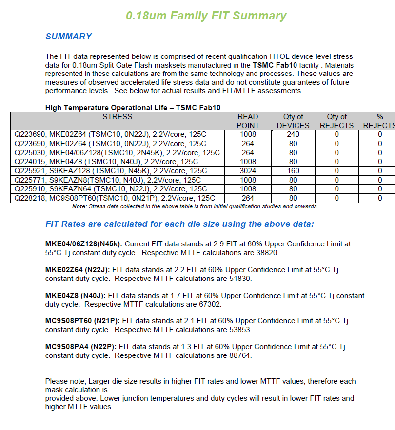

Hi.
Are MTTF/FIT values available for the Kinetis E series at all?
I would like to use it in a design but no reliability data is a dealbreaker...
Thanks!
1,138件の閲覧回数
kerryzhou
Hi jun yamada
   Please check this information:
Wish it helps you!
Kerry

jun1
Contributor V
Thank you very much. It was helpful.
