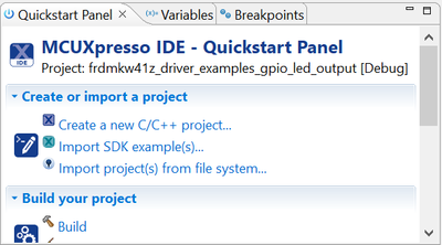

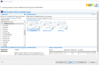

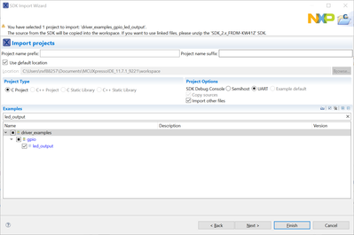

Under the "Quickstart panel", please select "Import SDK example(s)…", followed by selecting "frdmkw41z" from the SDK list, please make sure it is the latest SDK and the board's package. After this, search for the "led_output" project under the gpio folder and select "Finish".
This project is supported by the set, clear, and toggle write-only registers for each port output data register. The example takes turns to shine the LED.
After importing and building the project, changing the port and pin to PB0-2 can be made manually or with Config Tools.
