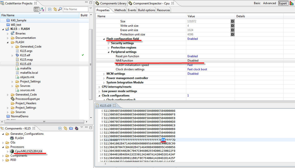

We have a problem on POR of MKL28 due to newer HW circuit connected to its pin 38 (PTA4) which is causing NMI on power-up & gets stuck in while(1){} loop.   That's because by default PTA4 is configured as ALT7 or "NMI_b" & MCU could be detecting a low input (-NMI) signal on that pin from the HW ckt which enables NMI.
Otherwise, if bootup reached my firmware, PTA4 will be assigned as ALT1, normal GPIO/output.
I've done some readings and from MKL28Z512V datasheet, page 72, I have do 2 things to disable NMI:
1.  remap NMI interrupt handler to other pin function (normal FW will do that).
2.  Disable NMI function by clearing FOPT[NMI_DIS] bit to zero which will take effect on next POR.
I found this 2013 post that shows how to disable NMI inside CodeWarrior IDE(?) for KL15.
https://community.nxp.com/thread/310241
(See image re-shown here below)
Does anyone know how I can do the same inside MCUXpresso for KL28 MCU?
Or better, how do I do steps 1 and 2 stated above in code?
I don't see any SDK example on this matter.
Thanks for the help.

So I changed flash config's 13th byte at 0x40d to be 39h whereby bit 2 NMI_DIS is changed from 1 (enable NMI) to 0 (disable NMI).

   (Edited to only change bit 2 of flash config byte 0x40d which is exactly the NMI_DIS bit.  So value 00111101 (0x3d) becomes 00111001 (0x39.)
Hi Robin,
THAT'S WHAT I'M LOOKING FOR!   I went to "startup" yesterday but I ignored & did not open the startup_mkl28z7.c file.   So I'll just replace single byte position 0x40d which says "0x3d" with "0x39" as stated on instruction in the reference manual?    Where NMI_DIS bit 2 changes from 1 to 0.

Robin_Shen
Hi MI,
Please find the Flash_Config in startup_mkl28z7.c then modify it.
Robin
