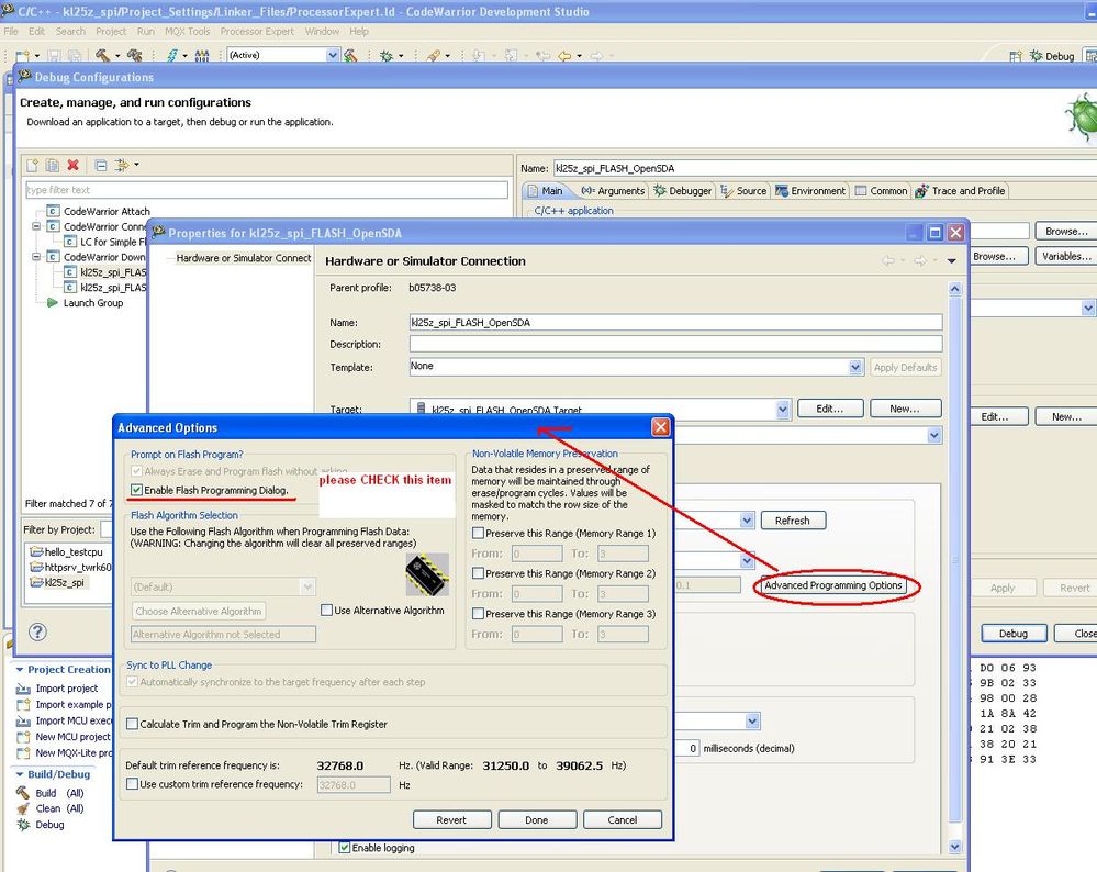

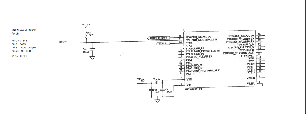

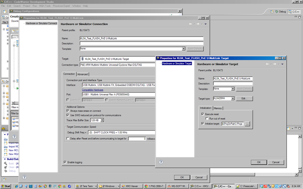

When using CodeWarrior 10.4 and 10.3 I can erase and partially program the chip on my bare board.  I used the same elf file and programmer to load simple program onto the kl05 freedom board without any problems.
Any help would be greatly appreciated.

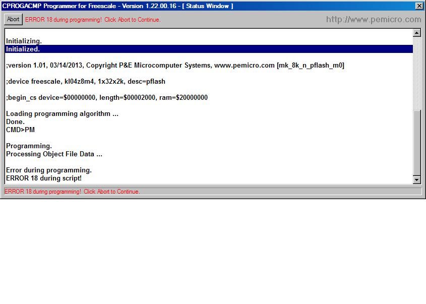

Turns out that there was a bug in the P&E micro algorithm for the KL04Z8 chip.  Here is the one that they sent me but I'm sure they will post an update on their web site.
there was an error in the processor expert code too, which had the wrong starting address for the RAM.

joevignola
I get a successful result from erasing the chip but I get an error returned when programming.  I have added the log messages below.
Thanks, Joe.

Starting 3rd party flash programming...
GDI: Mtwks Callback(MTWKS_CB_PROJECTACCESS, Section : STARTUP, Entry : SPECIFY_NETWORKCARD_ENABLED, Value : 0, R) => DI_OK
INF: Copyright 2012 P&E Microcomputer Systems,Inc.
INF: Command Line :"C:\Freescale\CW MCU v10.4\eclipse\..\MCU\bin\de.exe" -noni -language en -ORBendPoint giop:tcp:127.0.0.1: -ORBtraceLevel 0
INF: CMD>RE
INF: Initializing.
INF: Target has been RESET and is active.
INF: CMD>CM C:\Freescale\CW MCU v10.4\MCU\bin\Plugins\support\arm\gdi\P&E\freescale_kl04z8m4_1x32x2k_pflash.arp
INF: Initializing.
INF:  Frequency ~ 20971785
INF: (Recommended TRIM=$0089,FTRIM=1)
INF: Initialized.
INF: ;version 1.01, 03/14/2013, Copyright P&E Microcomputer Systems, www.pemicro.com [mk_8k_n_pflash_m0]
INF: ;device freescale, kl04z8m4, 1x32x2k, desc=pflash
INF: ;begin_cs device=$00000000, length=$00002000, ram=$20000000
INF: Loading programming algorithm ...
INF: Done.
INF: CMD>EM
INF: Erasing.
INF: Module has been erased.
INF: Initializing.
INF: Initialized.
INF: Done.
INF: CMD>PM
INF: Programming.
INF: Processing Object File Data ...
INF: Error during programming.
ERR: Error Programming flash of device
ERR: Error occured during Flash programming.

Hi Joe,
Seems only part of the codes have been downloaded successfully, I will check it with the CW team and let you know when I have any more information.
BTW, would you please show me the debugger configuration that you are using? just like below:
Thanks for your patience!!

joevignola
Here is my configuration
5,391 Views

joevignola
Here is the dialog that pops up.

joevignola
Here is the basic schematic that I'm using.
Joe.
5,391 Views
Kan_Li
Thanks for the information!! The schematics should be ok, but it still hard to locate the possible cause. Have you got another programmer such as Jlink to have a try? if not, I remember you have a FRDM-KL05Z , and its on board OpenSDA can be used to program the external device, would you please try it following the guide from Debug External Processors with USBDM and Freedom Board | MCU on Eclipse?
Please kindly let me know if the problem is still there.
