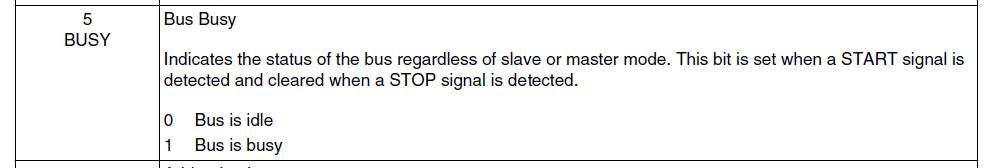

I have a question on using the I2Cmodule. I am writing the driver for an I2C EEPROM and I need to do the following for performing a read operation on the EEPROM. Note that after sending the address of the byte I want to read, I have to send a start again (without a preceeding stop). This doesn’t seem to be possible in I2C module.
How I am trying to achieve this is by doing two transactions on the I2C bus. First to write the “Byte addr” bytes. This I am ending without a STOP bit. The next to read the data byte.
bool eeprom_read_byte(uint16_t address, uint8_t * data){
    //Get the I2C instance handle
    I2C_Type * i2c_handle = NULL;
                        i2c_handle = i2c_shared_init();
    i2c_master_transfer_t masterXfer = {
        .slaveAddress   = EEPROM_I2C_SLAVE_ADDR_7BIT,
                                                .direction      = kI2C_Write,
                                                .subaddress     = (uint32_t) address,
                                                .subaddressSize = 2,
                                                .data           = NULL,
                                                .dataSize       = 0,
                                                .flags          = kI2C_TransferNoStopFlag
    status_t status = I2C_MasterTransferBlocking( i2c_handle, &masterXfer );
                        if( kStatus_Success != status ){
                                                PRINTF(("%s[%d], %s() - I2C_MasterTransferBlocking failed: %d\r\n", __FILE__, __LINE__, __func__, status));
                                                return FAILED;
    masterXfer.slaveAddress   = EEPROM_I2C_SLAVE_ADDR_7BIT;
    masterXfer.direction      = kI2C_Read;
    masterXfer.subaddress     = (uint32_t) address;
    masterXfer.subaddressSize = 0;
    masterXfer.data           = data;
    masterXfer.dataSize       = 1;
    masterXfer.flags          = kI2C_TransferDefaultFlag;
    status = I2C_MasterTransferBlocking( i2c_handle, &masterXfer ); è This always returns error kStatus_I2C_Busy
    if (kStatus_Success != status){
        return FAILED;
                        return SUCCESSFUL;
The “kStatus_I2C_Busy” is returned from the following code inside I2C_MasterStart() function and below is the explanation of this from the reference manual.
    /* Return an error if the bus is already in use. */
    if (statusFlags & kI2C_BusBusyFlag)
        result = kStatus_I2C_Busy;
Please suggest me how I can achieve the I2C communication needed to perform a read operation on this I2C EEPROM.

Look up 'Repeated Start'.  Note that parts that have double buffered I2C has  a bug in them related to Repeated Start.
There have been several discussion here on how to work around the issue.

General format for EEPROM read is:
Start
Device_Address Write
Write_EEPROM_ADDRESS_High (or low depending on the part)
Write_EEPROM_ADDRESS_Low
Repeated Start
Device_Address Read
Read/Ack
Read/Nack Nack indicates this is the last read.
The master still needs to generate the clocks so there needs to be more than one read.

I figure out from the Appendix you shared that the typical issue is that the i2c master, after sending the repeated start sends a wrong slave address. But this doesn't seem to be happening in my case. Here it seems to be that I am able to read but the slave is not returning the right information.
In this, I write 0xAA at address 0x0004 and then try to read address 0x0004. What do you think could be wrong here? Do you think its the double buffering bug? how?
Cheers,
Gaurav.
5,137 次查看
mjbcswitzerland
Specialist V
I am not sure whether this is a chip issue, driver issue or application issue yet but it looks like your write doesn't correspond to what you display in the initial post. There you show that you want
W50, 0, 4, W50, AA
but your oscilloscope is displaying W50, 0, 4, AA, which is different because the slave is never being addressed for the data write (the second W50 is missing).
In this case it may be normal that the read is a 0xff since you haven't written anything yet.
If you intended to send the second W50 between the 4 and the AA if could be the chip bug where the second start address is lost (as noted in the appendix of the uTasker I2C document).
Mark
5,137 次查看
