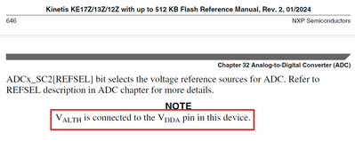

I am using TWR-KE18F board for my development. I have 2 queries as follows
1. How can I change the ADC's reference voltage to Internal reference and how much is the voltage? In the reference manual it is given as "The alternate VALTH voltage reference may
select additional external pin or internal source depending on MCU configuration. See
the chip configuration information for the voltage references specific to this MCU". But I couldn't find anything in the Datasheet.

The Valt should be VDDA.
For the KE1xZ device, There is a description shown as below figure, we can refer to this:
