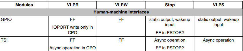

Dears,
Can you help to share MKE15Z TSI Low Power Module Wakeup Samples with me?
BRs,
Ray

dannydeng
Hi Mario,
  Seems only Power Module switch, do not including TSI wakeup configuration. Do you have this kind of samples?
BRs,
Ray

mario_castaneda
Hi Ray,
Unfortunately, we do not provide this kind of sample, it will depend on your implementation.
If you will use the TSI mutual mode or self-mode.You must merge the power manager and the TSI example.
For example: If you select the self mode, please look at the driver included in the SDK.
https://mcuxpresso.nxp.com/en/dashboard
The example is setting the TSI in the main function TSI_init(), also provide the key calibration TSI_keyCalibrate().
The Power manager example provides an API that let you configure the wakeup source. APP_SetWakeupConfig, you could select by a Timer or a Pin.
As you can see the TSI, has a Full functionality in most of the power modes that the MCU support.
