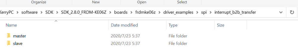

i suggest you test the official SDK code:SDK_2.8.0_FRDM-KE06Z\boards\frdmke06z\driver_examples\spi\interrupt_b2b\slave
at first, which can be downloaded from this link:
Welcome | MCUXpresso SDK Builder
Wish it helps you!
If you still have questions about it, pelase kindly let me know.
