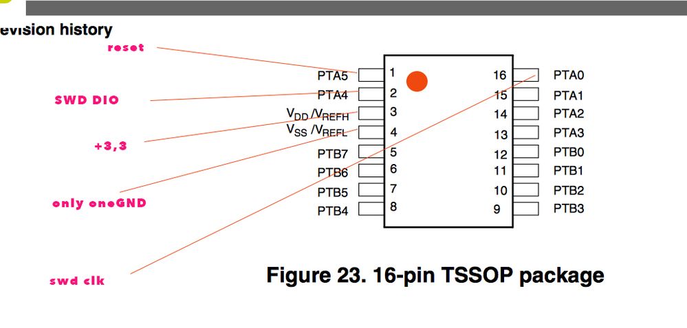

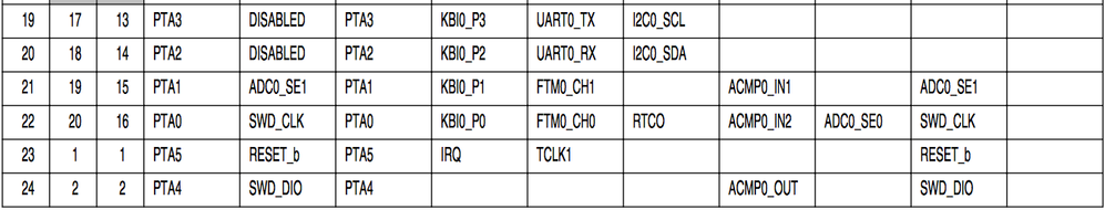

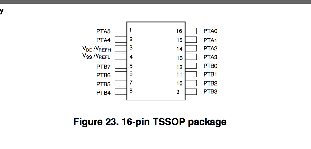

DATASHEET MKE04Z  BUT I DONT  SEE A POINT OF PIN COUNTING ON THE CHIP I SEE A ROUND MARK LIKE IMAGE DOWN.
PIN MAPPING
MY CONNECTION.
It was my first experience. And im sure i do something wrong or its no possible do flash or debug with kwikstik.
I have direct cables to the pins without capacitor, resistors.

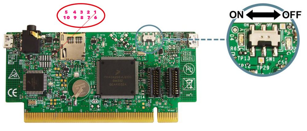

Here's the correct numbering of the pins SWD connector on KwikStik.
Good luck,
Adam.
