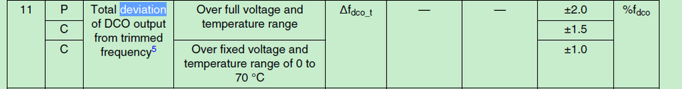

Hi Neil Porven,
     From your code, it seems you are using the internal IRC and trimmed it.
     From the datasheet, you can get that:
  The deviation is up to 2% over full voltage and the temperature range.
  When the deviation is larger, and it is out of the FLL DCO range, it will caused the FLL lock up failed.
   I suggest you choose the external crystal which can support 80 degree C, then try it again.
Wish it helps you!
Kerry

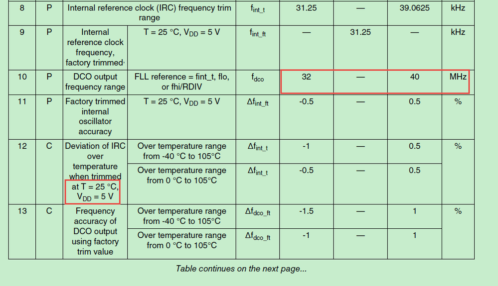

Hi Neil Porven,
   Sorry for my mistake, the picture I post is from the older datasheet.
Now the new datasheet can be downloaded from this link:
http://www.nxp.com/assets/documents/data/en/data-sheets/MKE02P64M40SF0.pdf
Page 22

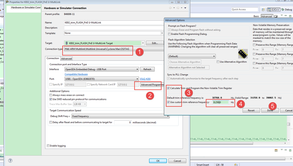

Now, there has two points you need to take care:
1. Trim configuration
  I don't know which code you are using? And how you get the trim data.
Normally, we use the Codewarrior or the KDS PE code,  like this:
Then use the PE debugger to trim it, it will save the trim data in address 0x3ff, and 0x3fe.
I also attached my test project for your reference.
You can trim the 31.25Khz which is the default trim data, please also take care, the trim temperature should in 25C, VDD=5V.
2. Make sure your FLL out (DCO) is in the range of 32Mhz to 40Mhz.
Please trim it in temperature 25C, 5V VDD at first, then add the temperature to 80C, check whether it still have this problem.
Wish it helps you!
Kerry

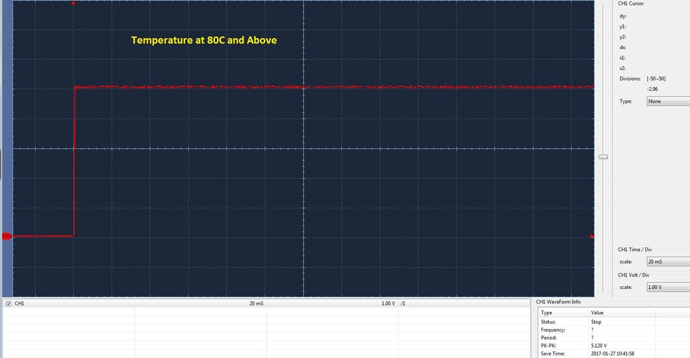

The results are the same, below the 80C  looking at my scope, I get a sharp pulse.
Above the 80C, its a HIGH pulse, indicating that it never leaves the while loop.

   Now, please give me your oscilloscope test wave when in 25C and 80C, then I will check it with our according department.
   Besides, did you have another board? You also can check another KE02 board, just use the internal IRC, and test it, whether it has the same result?
Waiting for your test pictures.
