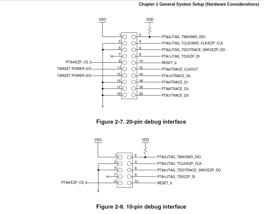

   I am working on a project that needed a custom board  using the kinetis mk66 microcontroller.
I have no space for a sda chip on the board so i am using the LPC LINK2 (J7) as the debugger using MCUXpresso IDE.
I have designed the jtag using the recommendations as per section 65.2 External signal description(page 2225/2247) and 10.3 Debug Port Pin Descriptions ( page 179/2247) with no external resistors attached.
The debugger soft loaded its firmware(CMSIS-DAP) and is seen by the MCUXpresso IDE.
I am powering my custom board from an external power supply so JP2 si off.
As this is my first design i have unfortunately not used the Reset_b pin and it is floating.
The first time i tried to flash the mk66,using the gui flash tool, i unknowingly performed a MASS ERASE and it looks like the reset mcu box is also ticked. Se i did a MASS ERASE + RESET and i have read it might be bricked ?

After adding the 2 NMI_b and Reset_b pins and pulling-up the TMS pin  I still cannot acces my microcontroller using the jtag-LpcLink2 and MCUXpresso IDE.
Things that are different in my JTAG hardware connections are :
As i am using the J7 of the lpc link2 i have routed my pins so that they match this schematic and not what you suggested.
Also i don't think i should route the PTA4/EZP_cs to pin9 of the 10 pin connector because the lpc_link2 connects that pin to GND so it would force my controller to enter EZPort mode, right ?

kerryzhou
Hi Bogdan Nica
   PTA4 is the very special pin, it is the NMI pin, so you need to add external 4.7K to 10K pull up in the pin.
   If you don't want to use the EZport, you totally don't need to connect PTA4 in your JTAG interface.
   From my opinion, you also can use the SWD interface, this interface just need 5 pins:
  VDD, VSS, SWD_CLK, SWD_DIO, RESET
  SWD_DIO need external 10K pull up resistor, RESET_b need external 4.7K to 10K pull up resistor and 0.1uf capacitor to ground.
  Then, you can use the JLINK firmware in the LPC-LINK2, then use the JLINK commander to connect the chip, if you can find the ARM core, it means your hardware is OK, if you can't find the ARM core, it means your hardware still have problems.
   Wish it helps you!

kerryzhou
Hi Bogdan Nica ,
   You CAN'T leave RESET pin floating!
   Reset pin should have external 4.7K to 10K pull up, and 0.1uf capacitor to ground.
  NMI pin need external 4.7K to 10K pull up resistor.
  SWD interface need these pin: VDD, GND, RESET, SWD_DIO, SWD_CLK.
  SWD_DIO need to add external 10K pull up resistor.
  You must make sure your hardware is OK, otherwise it will have problem.
  I suggest you use the LPC-LINK2 with the jlink firmware, then use the JILNK commander to connect your board, if it can find the ARM core, it means your hardware still have problem, you need to check the hardware at first.
  So, please use the JLINK commander to connect your board at first, then give me the result.
Wish it helps you!
Kerry

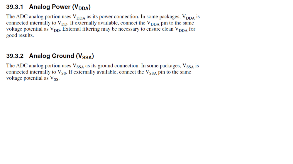

bogdan_adrian91
Cool,
Thx for the reply.
I will be doing some improvements on my pcb and i have a couple more questions :
1.  I will be using JTAG so what pull should i use for JTAG_TCLK , JTAG_TDI, JTAG_TDO, JTAG_TMS(pull-up) ,JTAG_
TRST_b ? And why isn't the internal pull enough ? Are the values of the pull resistors to low ?
2. Also , i have seen various comments about how to wire together VREFL and VSSA pins together.I will not use any analog supply nor any ADC functionality si is it ok if i just wire VREFL and VSSA pins together and ground them or should i add anything else ?

kerryzhou
Hi Bogdan Nica,
     Answer your two questions:
1. About the external pull up
You can refer to this document:
https://cache.freescale.com/files/32bit/doc/quick_ref_guide/KQRUG.pdf
Internal pull up is weak, so to work stably, it's better to add the external pull up resistor.
2. To the unused power pin
   It's better to connect it to the expected power.
   So, it's better to connect VDDA VREFH to VDD, VSSA VREFL to GND.

bogdan_adrian91
I have currently connected VSSA and VREFL to GND as this is what i have found on FRDM-K66F schematic.
I have also connected VDDA and VREFL to VDD .
Will this not work out ?

kerryzhou
Hi Bogdan Nica,
   So sorry for my misleading in the last reply, it's totally mistyping.
   So,  you connect VSSA and VREFL to GND, it is correct.
   You can refer to the FRDM-K66 schematic.
