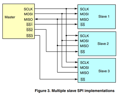

Hi, I want to use the DSPI to work with PGA (Gain Amplifier) and external ADC. Kindly help me to setup the source code that work well with this scenario. I can send the data to PGA and control the gain of the input signal, I don't understand how can I receive the data from ADC?
ADC # AD7940BRMZ
PGA # MCP6S26-I/ST
See the attached schematic for understanding. Thank you

Pavel_Hernandez
I review your image but I don't understand the diagram, there are lines without a name, Could you provide me more information about your connection?. I found this application note [MPC5121e Serial Peripheral Interface (SPI) (nxp.com)] is not for the same MPC, but maybe will help you. Are you trying to do this?

fshah30
Hi, Please find the attached SCH for your review.
There are TWO parts
1- send the data to Gain Amplifier chip which is working fine, I can see gain increase and decrease in oscilloscope
2-  Read data from ADC chip which is not working.
See the attached code for your review. Please let me know where I am doing wrong? Thank you

Pavel_Hernandez
I review the schematic and I understand the next.
You are using the k64 to send commands of SPI to the MCP, this works fine, but when you configure the MCP to the ADC should answer back to the K64?, tell me if I'm wrong.
But I do not see the problems are in the K64, if your problem is about the ADC you need to contact the vendor for getting more details. I suggest reviewing the frequency that can be supported by the ADC, I reviewed the datasheet of the ADC, and check if you are using the CS correct this starts the frame.
