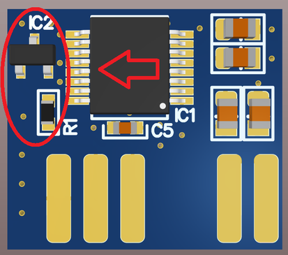

There can be 2 approaches - either a different board for each case or something in between terminals and cpu.  And we decided to go the 2nd way - piggy-back boards.  Then, you can have CAN or UART on a piggy-back and with a different transceiver we have a solution.  We used also different radio boards to support various radio networks.
Formerly we used the MCF51CN128, which perfectly fitted into the constrained design, modems with MKL02 are nice - see photo in an article here.  Now, we are adding a control unit in a same form to fit into nearly every occupied.cabinet.

Initially, I placed 24C01 EEPROM but even if there is 1 chip available with SOT23 package, there can be a potential of creating I2C "start" condition. Finally I was browsing Maxim's and DS28E05 marched along. However its DQ will reside on a same signal as a transceiver direction one, I think they will be "frequency isolated" from each other, as 1-Wire has faster timing. And this solution also fits same board dimensions.
Adding DS28E05 for identification.Adding DS28E05 for identification.

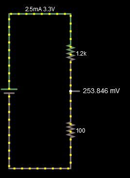

Your comment escalated me to check current conditions (you can also read my P.S. at end).  We are using pin 97 (PTD4) of MK60DN256vll10.  Kinetis has 3 mA only if Vcc < 2.7V. We use 3.3V.  Both Ioh and Iol are 9 mA for high drive strength, 2 mA for low drive strength.
When Kinetis drives the signal low, the MOSFET in 1-Wire is closed and its 100R does not influence the circuit.  You are right 3.3 mA is too much, better to use 1k2 or the limit 1k5 as per the datasheet of the DS28E05.
When DS28E05 drives the circuit low, there will be 2.5 mA current to DS28E05 - we does not care.  The voltage on Kinetis will be 250 mV (as per simulated R-divider screenshot below) which is far below 0.35 x 3.3 = 1.155 V threshold. Why do you call it "strange low" voltage? Because polite CMOS pulls down to zero?
Now the ADM3485E - it has 2 uA input current on !RE. Same has MAX3485 with minimal input impedance 1k for 1st transition only.  Why do you think this can influence circuit conditions?

"Strange Low" voltage when 1-Wire transmits"Strange Low" voltage when 1-Wire transmits

A "strange low" (for lack of a better term) is what I call it when you have multiple drivers on the line - what happens when the K6x drives the line low and the DS28E05 dumps current (stored in the device's capacitors because the line has been dropped) - you might see the line rise over the 1.155V threshold some time later.  It's probably less of an issue when the line goes high because you will be, by definition, not receiving data but the DS28E05 may cause problems on the line going low.
With your analysis, "might see" is probably a very low probability, but I strongly suggest you scope the operation of the line during making !RE active.
I'm cautioning you for two reasons, the first is that the power-up/power-down sequeces and current draws are not documented in the DS28E05's datasheet.
The second is experience.  I've been in a number of situations where multiple drivers on a logic line do not work as expected.  There is the 2.5mA draw which you seem to be accouting for as well ensuring the pin is driving at 9mA but there may be something lurking out there that is going to cause a problem - it sounds like you've dealt with that type of problem before.  Going over the datasheet again, Maxim notes that mutliple one-wire devices can be on the same bus, but does not comment on using the bus for different signal types.
Good luck!  Chances are you'll be fine, but make sure you do some testing to ensure there won't be any problems.
