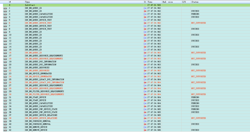

But my custom board always enumerates error,the Port Monitor capture is as following:
what is the trouble?
Are there any conditons that not meet or tips I miss?
I have already tripped in this situation for days,Waiting for help!

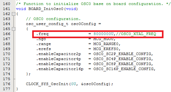

c. the external oscilator is 8MHz

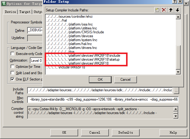

as the KSDK1.3.0 has no usb sdk lib project for MK26,I can only do it on the bases of MK65F18

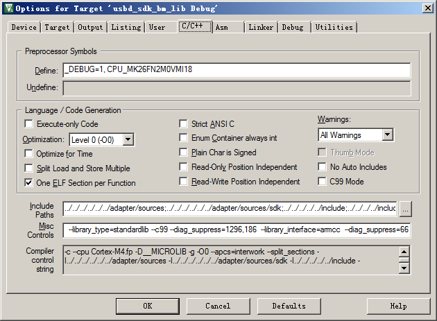

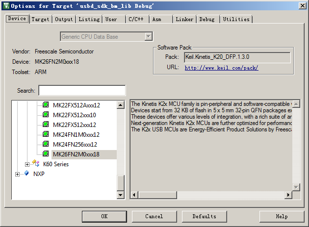

open the MK65F18 usb lib project,I have changed some configureation:
a. Device and Target to be MK26
b. C/C++
change Define to be CPU_MK26FN2M0VMI18

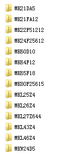

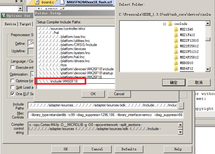

in the include paths:
change the finally folders directed to MK26F18
because in the usb_core,there is no MK26,so the Final MK65F18 is use instead
after all these, I compiled it

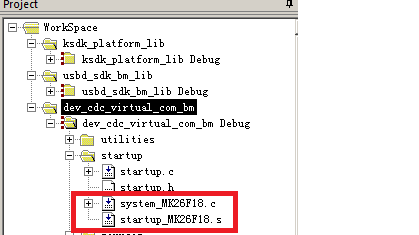

a. update configurations as step3 above
b. update the start files from MK65 to be MK26

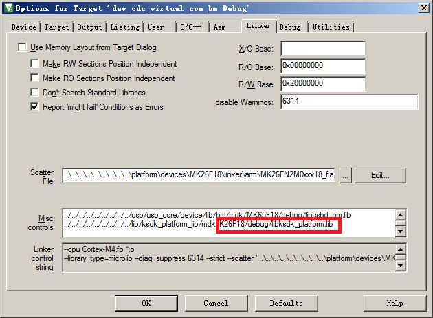

c. Link lib

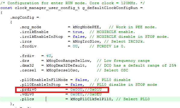

d. after all these,I config the clock in board.c file to make the MCG out is 120MHz
5. Finally,I compile the project and debug with a Jlink Debuger,with no luck,the usb is still no recgnized
SO, where am I wrong? Please help me figure out
