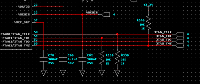

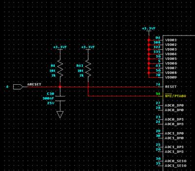

 Some programmers like the cyclone can supply the voltage to the device and they can hold the reset pin in low to enter to programming mode. – Attached circuit drawings

 If the device is already mounted on the board, please check that you have the pull up on the reset pin also a proper connection on the SWD pins ?
Yes the reset pin was pulled up and properly connected

If the device is already mounted on the board please check that you have the pull up on the reset pin as well as a proper connection on the SWD pins.
               There is a 10k pull up resistor for the nReset on every PCB we tested, unit(s) were verified to have proper solder connections to all pins on device. All devices show 1.2V on NReset pin and do not accept programming when held low and develop an internal failure if reset pin is driven to the proper voltage value.
Do you have an external pull up on NMI pin?
               Yes, there is a 10k pull up resistor to 3.3V.

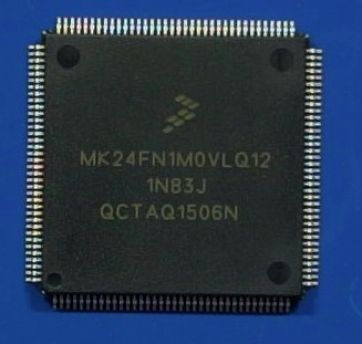

Unit Image of the part

thanks for the information, the part is date code 2015 week 06 maybe it is damaged.
where did you buy those parts?
was it on his original ESD bag?
Did you see any signal on the SDW clk when you try to program it?
