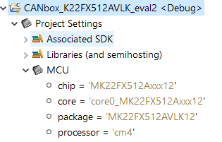

Hi, I have a custom board with MK22FX512AVLK12. The MCUXpresso Pins and Clocks tools recognize this MCU however the Peripherals tool does not.  It reports the following message:
This is surprising since the MCUXpresso Supported Devices Table (July2021) states Peripheral Tool is available for K22 product family.
Have I misconfigured something? I am not sure where to check other than project settings:
The real issue behind the need for peripheral tool is to get USB working on this MCU. I have tried example projects form FRDM-k22 and twrk21 and the code compiles, but I get "A request for the USB device descriptor failed." during enumeration attempt.

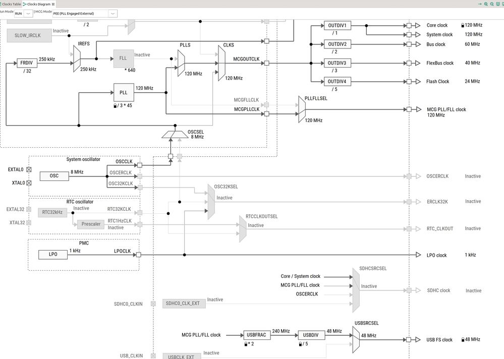

I think the clocks are ok:

First off, you didn't show the full clock wizard - Having a 48MHz USB clock out doesn't show the full story.  Here is my clocking diagram for my MK221M0Axxxx implementation:

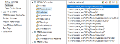

Next you have to make sure your build preprocessor and includes have to be correct.  You're looking in the right spot.

8. Open "Properties"=>"C/C++ Build"=>"Settings"=>"Includes" and match the following includes:
"${workspace_loc:/${ProjName}/board}"
"${workspace_loc:/${ProjName}/source}"
"${workspace_loc:/${ProjName}/}"
"${workspace_loc:/${ProjName}/usb/device/source/khci}"
"${workspace_loc:/${ProjName}/usb/include}"
"${workspace_loc:/${ProjName}/osa}"
"${workspace_loc:/${ProjName}/drivers}"
"${workspace_loc:/${ProjName}/CMSIS}"
"${workspace_loc:/${ProjName}/freertos/include}"
"${workspace_loc:/${ProjName}/freertos/portable}"
"${workspace_loc:/${ProjName}/utilities}"
"${workspace_loc:/${ProjName}/startup}"
"${workspace_loc:/${ProjName}/usb/device/class/cdc}"
"${workspace_loc:/${ProjName}/usb/device/class}"
"${workspace_loc:/${ProjName}/usb/device/source}"
"${workspace_loc:/${ProjName}/usb/device/include}"

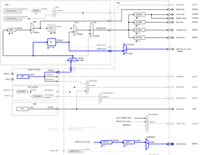

I reviewed my clock tree and it was very close to the one you posted. The only difference was the PLL (/2 *30) instead of (/3 * 45). I am not sure if it makes any difference.

Here is my clock config:
