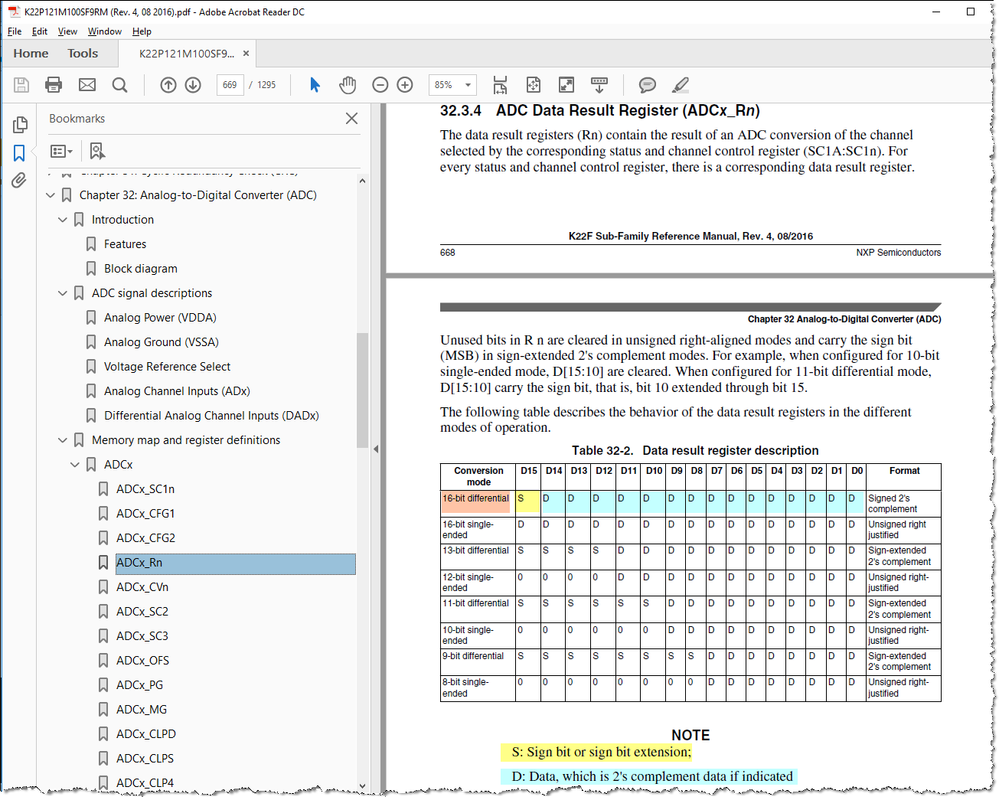

I'm currently working on the adc of the MK22FN128VLH10 microcontroller. I used the example, given with the FRDM-K22-board, to initialize a differential channel in 16bit mode. The outputted value is only half of the actual value. I've checked the hardware. The voltage is applied correctly to the pins.
Is there any configuration I have to make to make the adc work correctly?

Robin_Shen
Hi Philipp Thornhill,
I didn't find any obvious problems.
Would you please show us the outputted value and voltage applied correctly to the pins?
Additionally please notice the Data result register description of 16-bit differential mode.
Robin
1,314 次查看
philippthornhil
Hello Robin Shen,
Your picture helped me to solve my problem. The problem was, that i didn't notice the sign bit. I have written a function with which the applied voltage can be calculated on the basis of the measured adc value. This function showed me the wrong voltage value, because of the wrong resolution.
