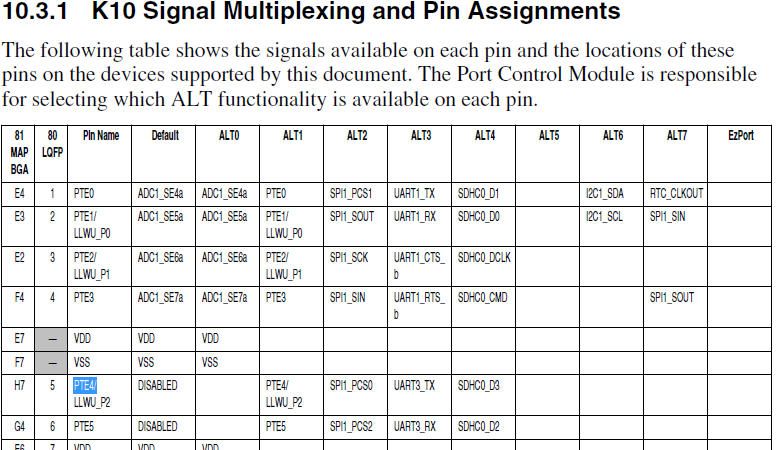

I have add PWM function,but i can't select PTE4 as output pin ?
776 Views
Robin_Shen
Hi 志權
The Output pin what you can select should have this function.
In the Reference Manual "K10P81M100SF2V2RM.pdf" of your MCU , the PTE4 doesn't have the PWM function.
Hope that help.
