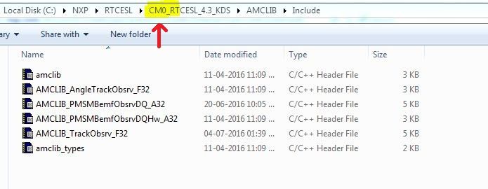

I am using my own board of MKV10Z32VLC7 which belongs to Cortex-M0+ Based Microcontroller. While I trying to porting the code I found that there is no ALPHA and BETA coordinates for the M0 based microcontroller in the source code.

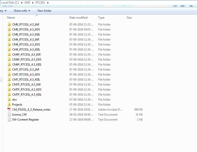

I downloaded the source code from NXP site as executable file named RTCESL-CM-4.3.exe, after I get installed it saved in C:\NXP\RTCESL(attached a screen shot).
As per the User guide available in the folder, I have added the library files into my project and it get compiled for all other libraries except ALPHA and BETA coordinates which is not available in the C:\NXP\RTCESL\CM0_RTCESL_4.3_KDS\AMCLIB\Include(attached a screen shot).
But the ALPHA and BETA coordinates are available in all other M4, M4F, M7 and M7F based microcontroller(AMCLIB_PMSMBemfObsrvAB_A32).
When I tried to add manually or copied all the AMCLIB file from M4 version it doesn't support that, am using Code Warrior 10.6.
What should I do  for the M0 based microcontroller to get ALPHA and BETA coordinates???

pavelrech
The functions AMCLIB_PMSMBemfObsrvAB_F16 and AMCLIB_PMSMBemfObsrvABInit_F16 were intended only for devices based on CM4 or CM7 cores. These functions are not part of CM0 libraries. The chapter AMCLIB_PMSMBemfObsrvAB should not be in CM0 userguides - it is an issue.
Do you want to you use the PMSM observer in AB coordinates on CM0 based devices ? If so these functions can be added for CM0 platform in next RTCESL release 4.4.
