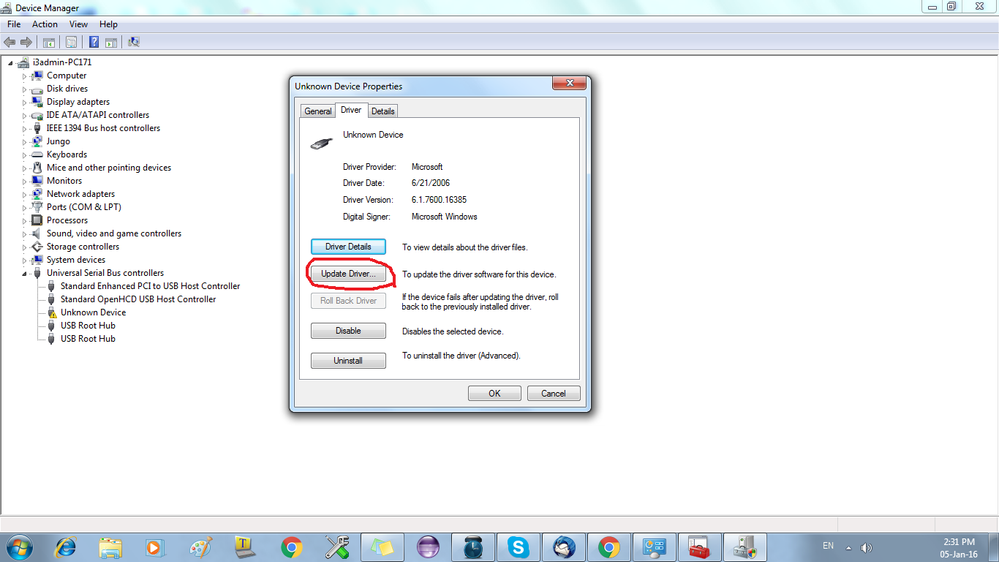

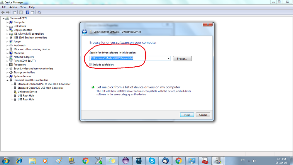

sooryakrishnanu
Hi Jingjing,
                    This is what my device manager shows when i connect the twr-ser usb port to PC.
21,908 Views

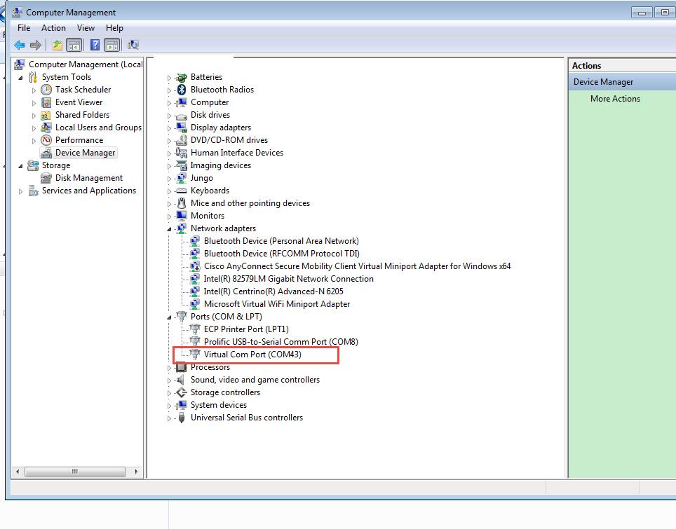

kerryzhou
Hi Sooryakrishnan U,
  Please refer to http://cache.nxp.com/files/analog/doc/app_note/AN4323.pdf?fsrch=1&sr=1&pageNum=1
Page 31, item2, install the COM driver.
Did you install the COM driver?
Jingjing

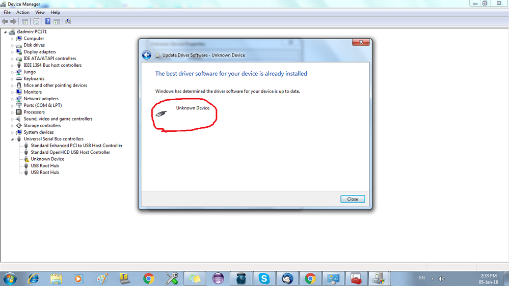

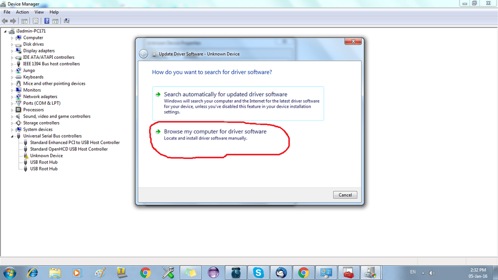

sooryakrishnanu
Hi Jingjing,
          Yes, I have installed the com driver.My system is 64 bit and i installed the virtual com driver from Freescale/Med GUI/Drivers/x64/VirtualComPortx64.But now when i try to update the unknown device driver with the com driver i have just shown,it again shows unknown device.I see it like the driver is not getting installed as it  got installed when i first used med-ekg demo.Untitled7.pngUntitled8.pngUntitled9.pngUntitled10.png

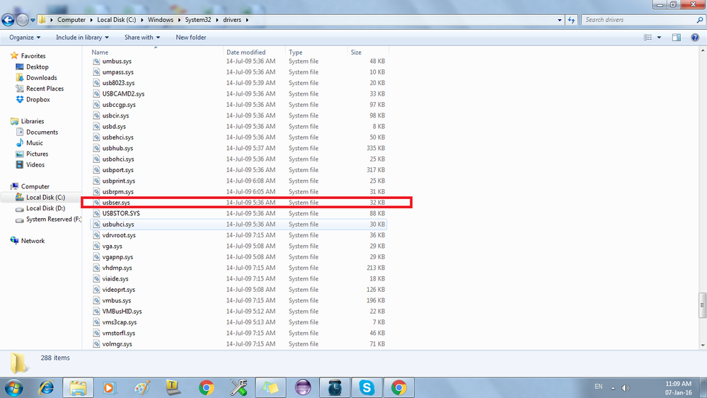

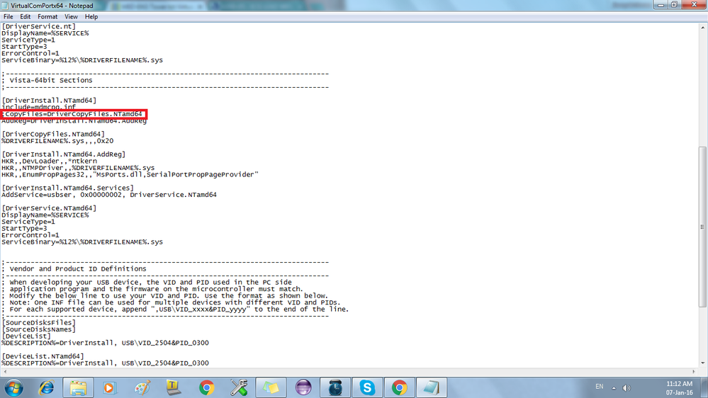

kerryzhou
Hi Sooryakrishnan
It is really difficult to find out the window's problem, and I am not the expert of the windows engineer.
A simple way is reinstall the computer.
Or you can try to use anther computer, and check whether the com port can be found!
Besides, I find some Chinese customers use this way, you can try it:
1: Check whether your file "usbser.sys " is lost in folder:C:\Windows\System32\drivers
   Check whether file"mdmcpq.inf" is lost in folder C:\Windows\inf
  If lost these files, please find it from my attached zip file, unzip it, and copy "usbser.sys" to path C:\Windows\System32\drivers
  copy "mdmcpq.inf" to path: C:\Windows\inf
2:  modify the info file in C:\Freescale\Medical GUI\Drivers\x64
comment :CopyFiles=DriverCopyFiles.NTamd64
just like the following:
; Vista-64bit Sections
[DriverInstall.NTamd64]
include=mdmcpq.inf
;CopyFiles=DriverCopyFiles.NTamd64
AddReg=DriverInstall.NTamd64.AddReg
[DriverCopyFiles.NTamd64]
%DRIVERFILENAME%.sys,,,0x20
[DriverInstall.NTamd64.AddReg]
HKR,,DevLoader,,*ntkern
HKR,,NTMPDriver,,%DRIVERFILENAME%.sys
HKR,,EnumPropPages32,,"MsPorts.dll,SerialPortPropPageProvider"
[DriverInstall.NTamd64.Services]
AddService=usbser, 0x00000002, DriverService.NTamd64
[DriverService.NTamd64]
DisplayName=%SERVICE%
ServiceType=1
StartType=3
ErrorControl=1
ServiceBinary=%12%\%DRIVERFILENAME%.sys
then save it, try to install the CDC driver, and select this driver file again.

sooryakrishnanu
Hi Good day Jingjing,
     I have tried everything you said, I can find usbser.sys and mdmcpq.inf in their respected file locations.I tried commentingCopyFiles=DriverCopyFiles.NTamd64 this as well but no change when installing cdc driver still it shows 'unknown device".

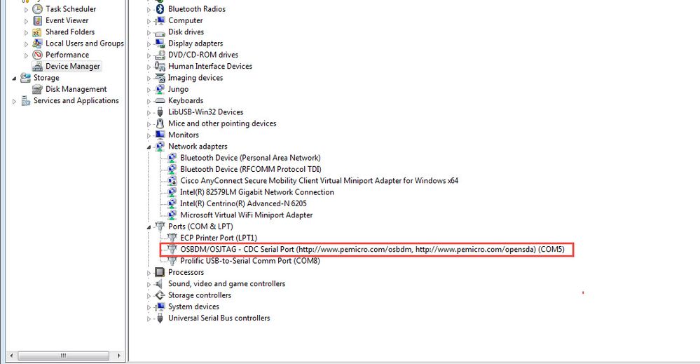

kerryzhou
Hi Joice Markose,
     Welcome join the discussion!
      If other computers all not OK, we really should check the hardware . Do you just have one board? If you have other board, you can try another board, then we can make sure it caused by the hardware, not the computer driver problem.
      When you just connect the TWR-K53 board, and without the TWR-SER, can you find the OSBDM/OSJTAG COM port?
     Just like the following picture:
Or no COM appears, just can debug and download the code?
Waiting for your reply.
