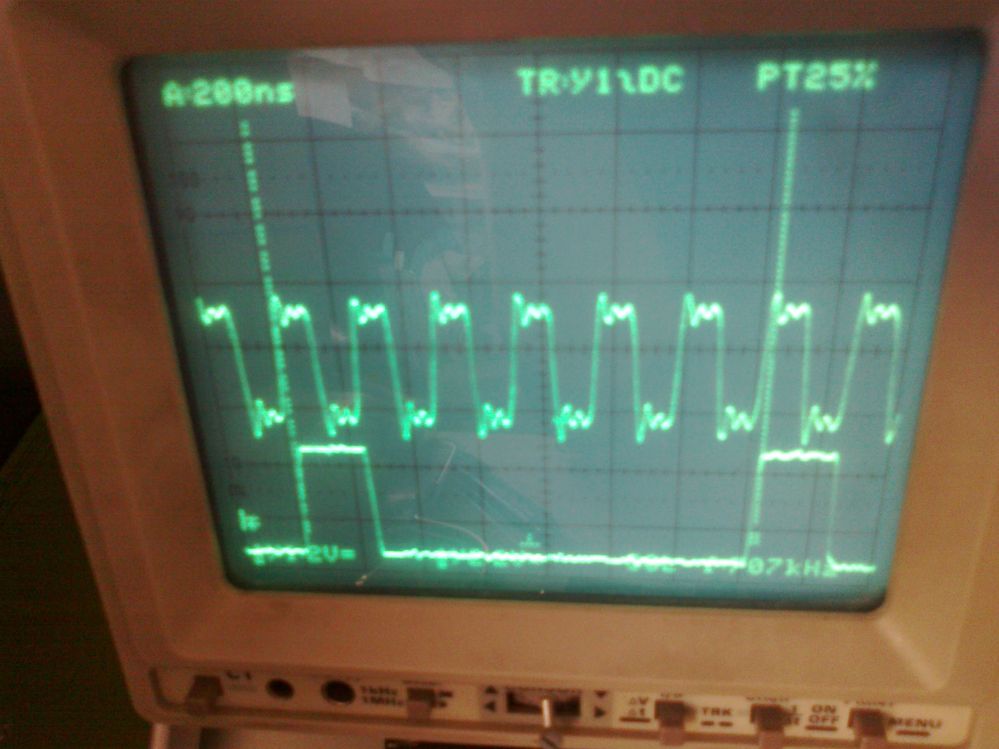

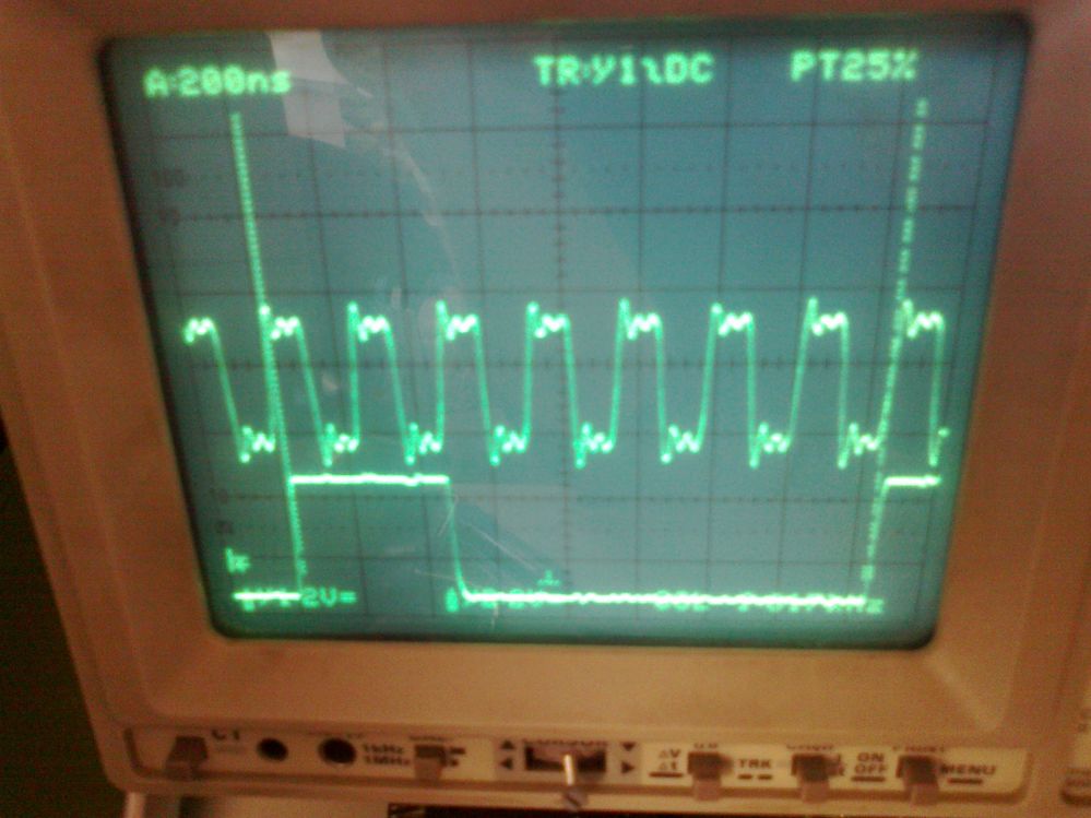

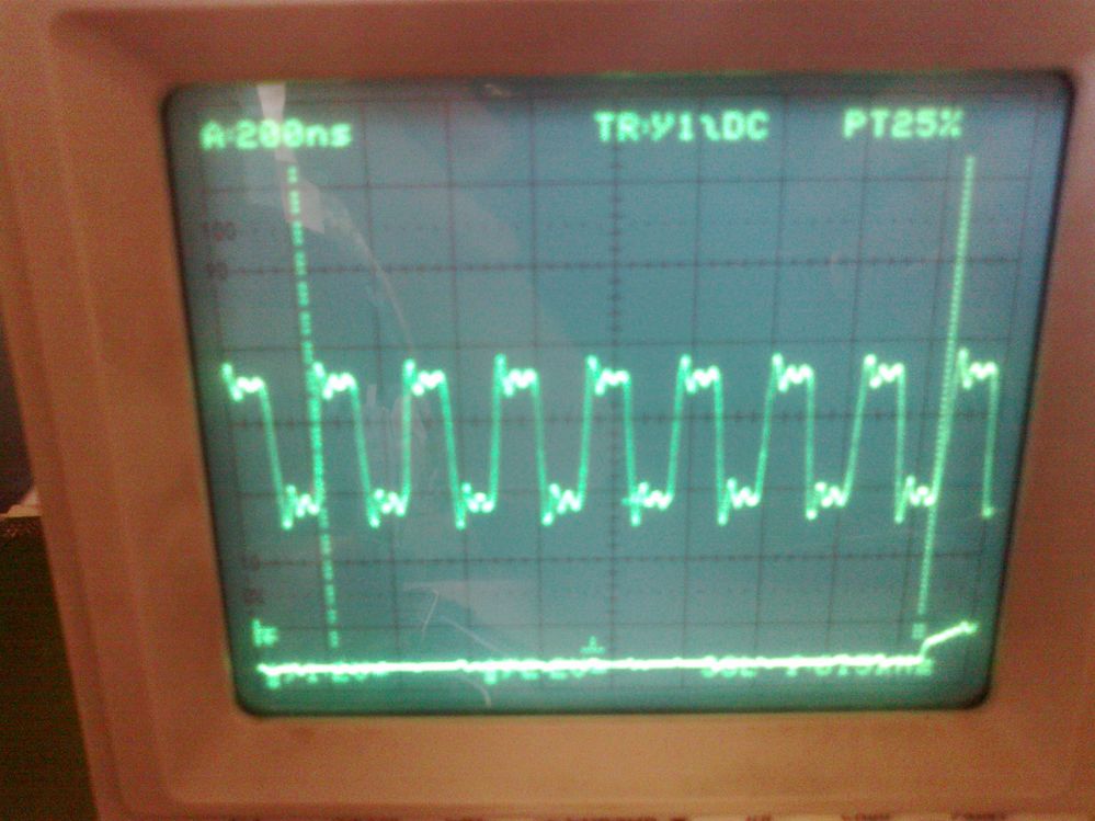

rothkarl
Hi!
I've checked the waveforms!
First image:
Maybe it's not easy to recognise, but it seems like there is some trouble with my code. When my cpu reseted both signals are high.
After I press SW3 button you can see my first mdio trigger point as a trailing edge. The problem is as i can see that the data on the mdio line
changes on the leading edge, but i think it should change on the trailing edge. Another problem is that after two read sequences completed,
the mdc line continues toggling.
Second image:
Here you can see the two 1's. ST and OP fields...
Third image:
Fourth image:
Fifth image:
On the pictures above you can see the consequtive bit sequences marked with the cursor.
After the MDIO does not changes (idling) the mdc continues toggling, but that is quite bad thing.
I hope this helps you!

mjbcswitzerland
Specialist V
Roth
The MDIO changes correctly on the rising edge of the clock.
The MDC also always runs continuouly so there is no problems here - if you want to stpp the clock you can simply set MSCR = 0; and then set the speed again before you use it the next time.
I didn't look at the the signal details but basically the transfers are taking place so maybe you have a problem with the reading code - check for example that you have EIR  defined as a volatile register.

I've seen this very same waveform myself with the K64 I've chosen for my design, also trying to work through problems in bringing up the Ethernet using a Micrel KSZ8081 PHY. The scope trace very clearly shows the MAC is changing MDIO on the rising edge of MDC, but the IEEE 802.3 standard very clearly says that both the MAC (the standard calls it the STA) and the PHY are to sample MDIO on the rising edge of MDC. What gives?
18,867 Views
rothkarl
Dear Roger!
I think the problems may occure are not in relationship with the rising/falling edge problem, but it can be with the lack of external pull-up resistance on MDIO line. I recommend to solder one 1.5 Kohm 0603 resistor on the board because it was not populated by default.
I also dont understand the waveforms, but this time i can confirm that the board config is just fine, however an external resistor should be added.
