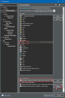

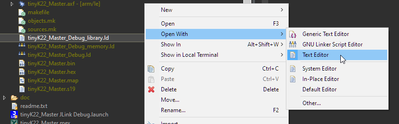

To disable the syntax checking, I'm using the following:
Change the editor to be used with Open with:
This will use the normal text editor for it.
Other *.ld files are not affected.
To change it globally, go to workspace preferences and change the default for all *.ld files:
I hope this helps,
Erich
