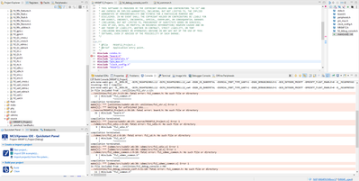

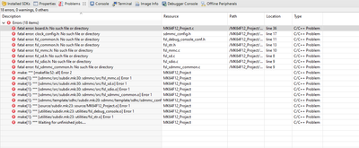

Recently, I created a MCUXpresso project with FDRM-K64F demo board (I have downloaded and imported the SDK) but when I try to build the project, the following message appear : "fatal error: fsl_common.h: No such file or directory"
Anyone know what is going on ? And how can I fix the problem ?

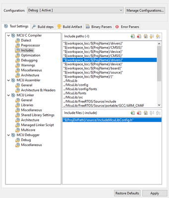

You have to check your compiler settings, if the necessary include folders are present in the -i list:
In your case the 'drivers' seems to be missing in the list:
Make sure it looks like in the screenshot above, or as this:
"${workspace_loc:/${ProjName}/drivers}"
Notice the double quotes around the path, just in case your workspace path has spaces in it.
I recommend that you check (or share) the console output you have in your screenshot for the commmand line passed to the compiler too.
I hope this helps,
Erich

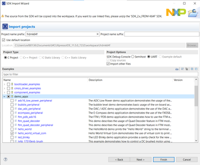

Regarding your issue, my suggestion is to import a SDK example like 'hello world' or 'led blinky', build the project and once there is no errors, then you can start developing your code.
To import a SDK example, you must go to the quick start panel 'import SDK example', select your dev. board, click on next and then you select the project to import and click finish. I will attach a couple of images as a guide.
Hope this was helpful, please let me know if you have more questions.
