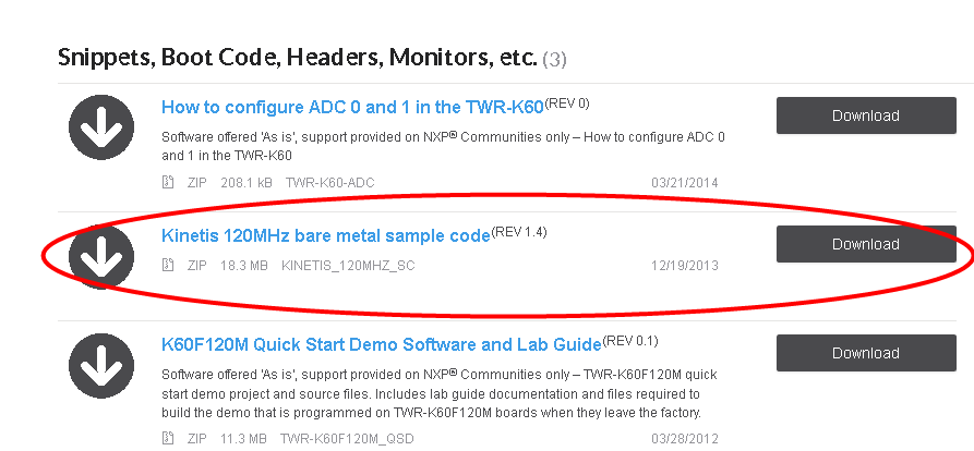

The MK60 F120 MHz is supported in KDS.  Is it also supported in MCUXpresso IDE?
it seems to support the MK60 D100 version, but not F120 version.
can you please let us know if there is any future plan to support F120 version?
Henry

Hi Henry:
Unfortunately there is no plan to support MK60F120M in MCUXpresso SDK now.
For K60f120,  you can use bare metal or MQX  for development.
TWR-K60F120M|Tower System Board|Kinetis MCUs|NXP
