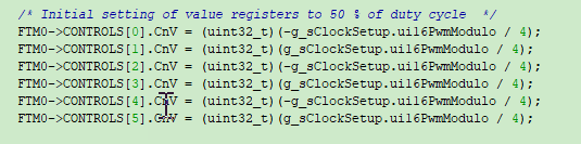

I debug the PMSM demo with FRDM-KV10Z board and get below result:
The FTM0 CnV registers value is:
You could find the function of  '-' is to bit inversion of variable value.
0xF8AE is bit inversion of 0x752 of 16 bit variable.
Wish it helps.
