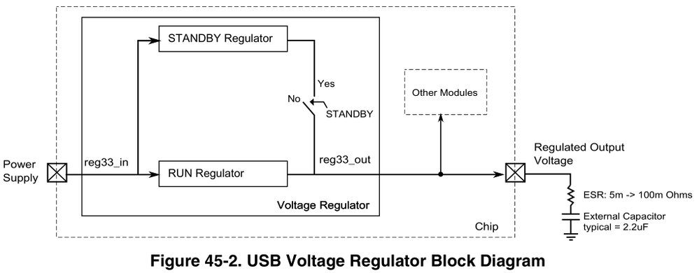

The second question I have is related to the 'internal regulator' mentioned in the different power modes. In my design I am not using the pins 'vregin' and 'vout33', mainly because I am already regulating a battery with an external regulator that also supplies other peripherals which need a higher current than the one provided by vout33. In this sense, I leave 'vregin' and 'vout33' floating, and use my regulated voltage as the input to the VDD pins. With this approach, am I affecting the functionality of the low-power modes since it controls the 'internal regulator'? or is the internal regulator a different one than the one used for vout33, and that is inside the uc after the VDD, in which case the approach of not using vout33 will still allow for the low power modes to work properly.

2) The internal regulator is enabled by default when power is applied to VREGIN. If USB is not used in your application, it is recommended to leave VREGIN and VOUT33 pins remain floating. This will not affect the functionality of the low-power modes. When the regulator is enabled, it can be configured to go to STANDBY mode in some low-power modes.
I see in the attached schematic that you are using the USB0_DP and USB0_DM signals, so if you are using USB in your application you need to connect VREGIN because the USB module powers from the internal regulator only.
Please take a look at section 3.9.1 Universal Serial Bus (USB) FS Subsystem in the reference manual for some example configurations. Also, the Kinetis Peripheral Module Quick Reference User Guide has more information about the USB module on the Kinetis family of MCUs.

Regarding my question 2, I indeed intend to use (in the future) the USB connection. Following your advice, then I will continue to power the VDD from the microcontroller from my external 3.3V regulator in the board, but at the same time will supply the pin VREGIN, so I can use the USB when needed (Am I correct?) If this is the case, should I just connect this VREGIN to the same 3.3V (already regulated) that I use for VDD, or should I directly use a 3.7V battery that is also available in the board? Is there any reason to choose for one or the other?
In addition, as I will not need the output of this regulator and will connect it only for USB purposes, then I will leave its output floating.

According to the datasheet, VREGIN voltage can be from 2.7V - 5.5V. When the input power supply is below 3.6 V, the regulator goes to pass-through mode. So in your case, you can use either, if you use your 3.3V regulated supply, the USB voltage regulator will be in pass-through mode and if you use the 3.7V from your battery the LDO linear regulator will be active. Also add a capacitor to the VOUT33 pin as shown in the following figure from the reference manual:pastedImage_1.png

Thank you!. I have done this, and have actually chosen to connect VREGIN to VUSB, so that it is only powered when USB is connected, as it is suggested in the datasheet, page 132.
