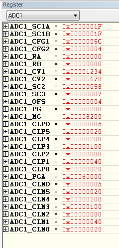

Please check my test code below:
   // REPEAT for BOTH ADC's.  However we will only 'use' the results from
    // the ADC wired to the Potentiometer on the Kinetis Tower Card.
    // Repeating for ADC1:
    ADC_Config_Alt(ADC1_BASE_PTR, &Master_Adc_Config);  // config ADC
ADC1 registers value is:

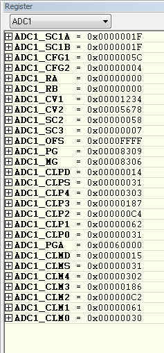

    //ADC_Cal(ADC1_BASE_PTR);                    // do the calibration
    //do manual ADC1 calibratin here.
    manual_ADC1_CAL();
After manual calibration ADC1 registers value is:
    // config the ADC again to default conditions
After that code, ADC1 registers value is :
I don't run the ADC calibration , just load the ADC calibration value into the related registers.

I had done a test. That should be ok for customer to load ADC calibration value to ADC module related registers.
Please check my test code below and the ADC conversion result is also OK.
void manual_ADC1_CAL(void)
    ADC1_OFS   = 0xFFFF;
    ADC1_PG    = 0x8309;
    ADC1_MG    = 0x8306;
    ADC1_CLPD  = 0x14;
    ADC1_CLPS  = 0x31;
    ADC1_CLP4  = 0x303;
    ADC1_CLP3  = 0x187;
    ADC1_CLP2  = 0xC4;
    ADC1_CLP1  = 0x62;
    ADC1_CLP0  = 0x31;
    ADC1_CLMD  = 0x15;
    ADC1_CLMS  = 0x31;
    ADC1_CLM4  = 0x302;
    ADC1_CLM3  = 0x186;
    ADC1_CLM2  = 0xC2;
    ADC1_CLM1  = 0x61;
    ADC1_CLM0  = 0x30;
Wish it helps.
