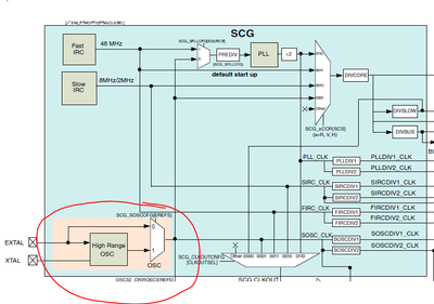

sean_dvorscak
Hi @Miguel04
So this is the trim value for the internal oscillator?  Is that part of the "High Range OSC" shown in figure 18-1 of the reference manual?
Would like to know more about what clock(s) exactly are affected by this and how exactly the trim value configures the clock?  Something like a formula.

Miguel04
Hi @sean_dvorscak
I've been looking for the information.
Every main clock of the SCG needs to be trimmed, and there isn't a specific formula for the clock to be trimmed, instead there is a register (for example SCG_FIRCSTAT) which coursely trim the Fast IRC Clock to within approximately ±0.7% of the target
frequency. Chapter 19.3.18 reference manual.
