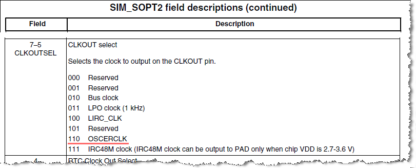

I see that you choose OSCERCLK to be output on CLKOUT but you haven't configured PTA12 to the CLKOUT function, which means that it won't be output.

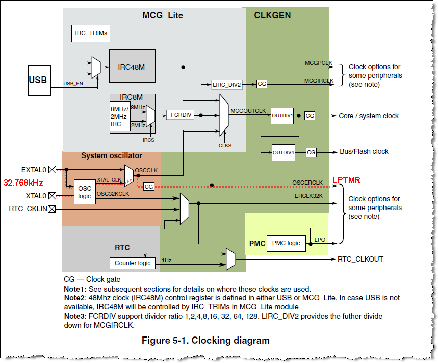

Apologies for the poor description as my question was written in the midst of frustration. My end goal is to use the 32 kHz crystal on the FRDM-KL0Z3 to toggle the LPTMR and utilize the interrupt routine. I seem to have been mixing up OSC32KCLK with CLKOUT, but this image below is essentially what I am trying to achieve.
I have been trying to get the CLKOUT function executed primarily for trouble shooting purposes but I still am not seeing a signal. There is no mention on EXTAL or any description of how to setup requirements in the FRDM-KLZ3 manual so I was not too sure where or if I was getting a signal as I could not measure it on an oscilloscope.
So basically I am trying to use the 32kHz OSC as the source for my LPTMR.

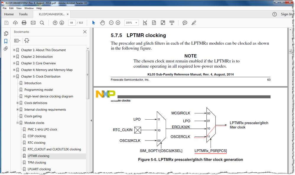

Robin_Shen
Hi Beau,
There is a 32.768kHz crystal on FRDM-KL03Z. But the RTC_CLKIN is floating.
I think you can select OSCERCLK as the clock source of LPTMR:
LPTMR_BWR_PSR_PCS(LPTMR0, 0b11); //Sets LPTMR clock to MCGIRCLK (00), LPO Timer (01), ERCLK32K (10),OSCERCLK (11)

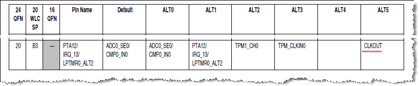

The PTA12 can be configured as CLKOUT function and then output OSCERCLK clock.

2. Configured the pin Mux for PTA12 for CLKOUT operation
