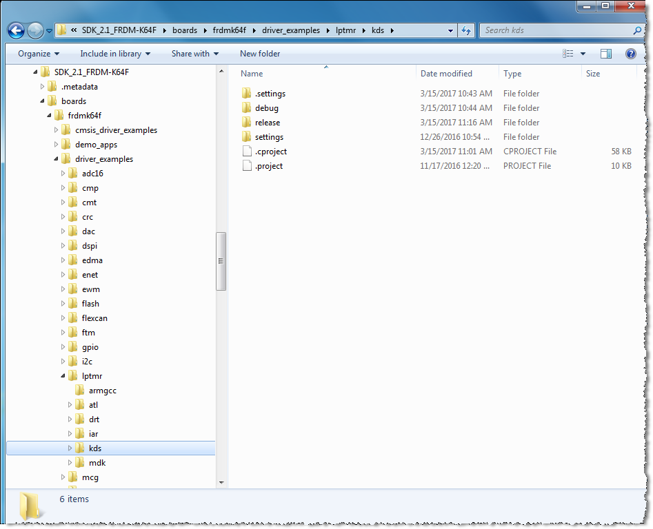

Would you please tell us the version of KDS IDE are you using?
I test the lptmr driver example in SDK_2.1_FRDM-K64F with KDS3.2.

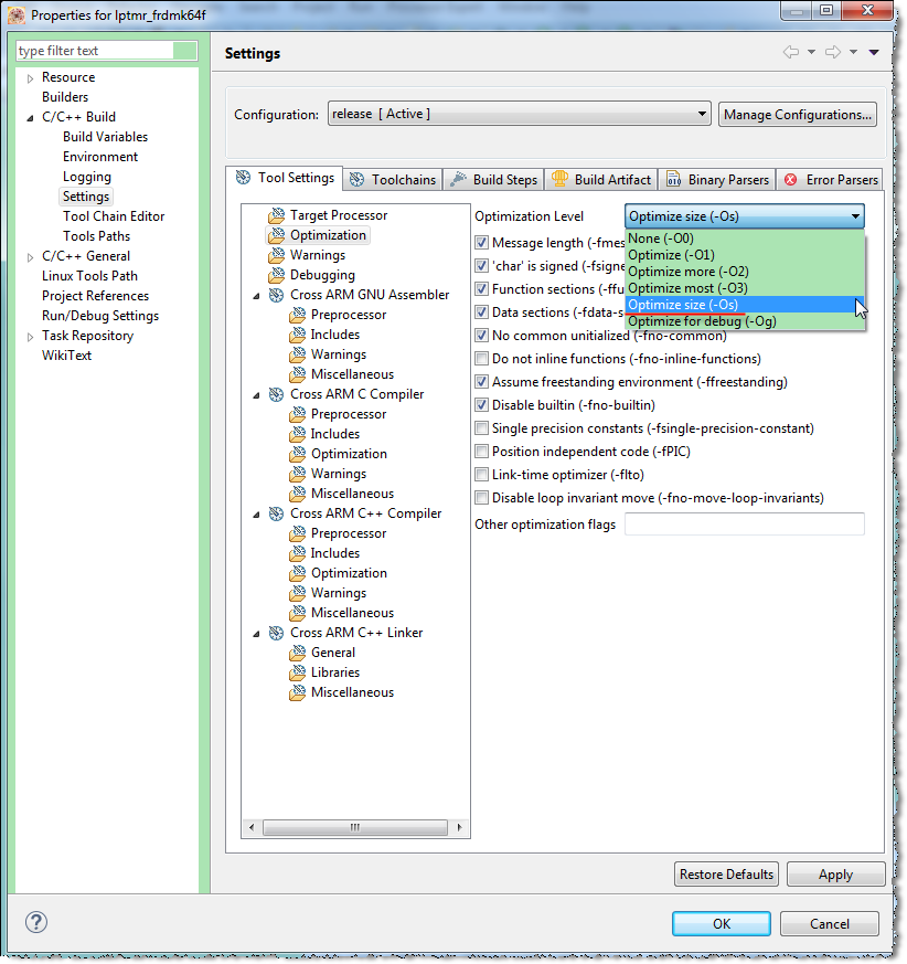

The red led will toggle with the default Optimization setting of release mode.

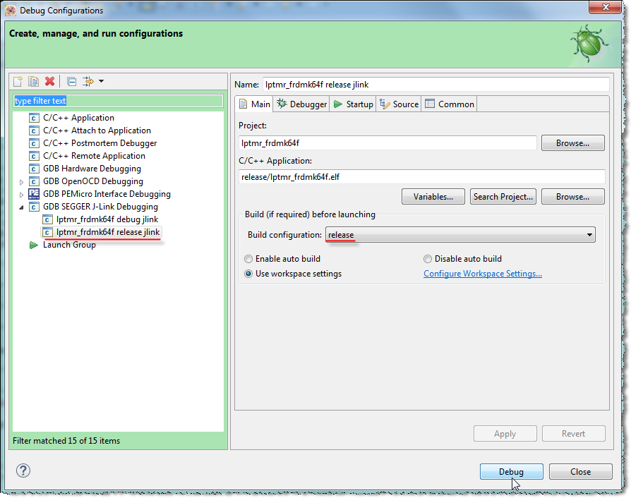

I've changed the optimization settings to '-none' and then interrupts came back. Other opt settings didn't work.
