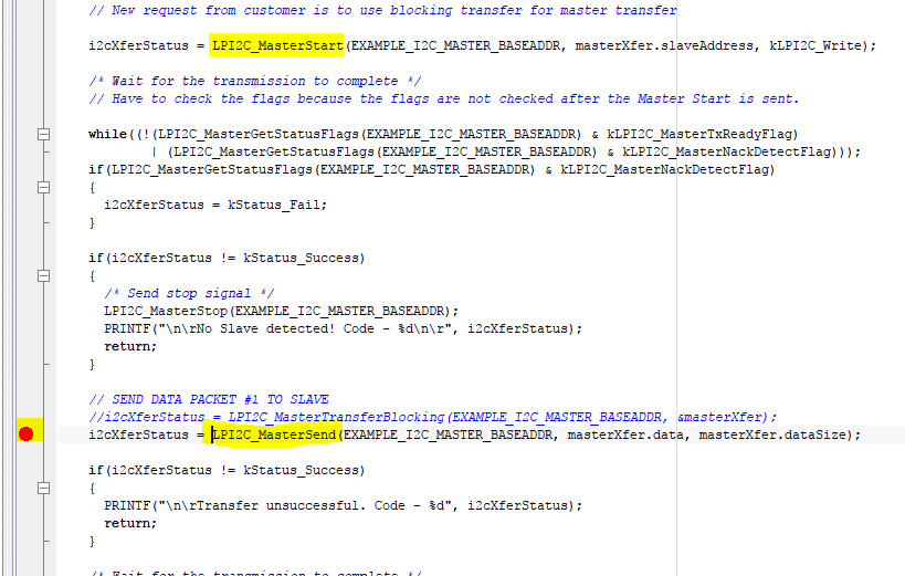

Take a look at a read of the accelerometer on the FRDM-KL28Z that follows:
The accelerometer is addressed for a write and the value 9 is subsequently written to select the internal register to be read from, then a repeated start is send to address it for the subsequent read. Only the start of the subsequent read is shown but all works fine.
I repeat, but this time set a break point after the first address byte has been sent – with the DBGEN set to '1' (meaning that the LPI2C will stop when debug mode is entered).
As can be seen, the start condition is sent, followed by the address - and the bus remains busy.
When the debugger continues, the second byte is sent, followed a stop condition.

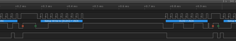

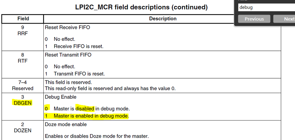

Now I repeat again but this time with the DBGEN set to '0', meaning that the LPI2C continues to run in debug mode.:
Now it is seen that a STOP condition has been sent by the LPI2C.
When the code continues, it tries to send the data byte but can't because the bus is now idle – it can only continue if it sends a new start bit.
It turns out that the LPI2C sends a STOP condition if there is nothing in the Tx FIFO, meaning that if the FIFO can't be filled before this takes place the transfer will be terminated. Firmware must thus keep up otherwise any Tx FIFO underflow will terminate a cycle and hence cause failure.
This is exactly what is explained in the AUTOSTOP feature in the LPI2C_MCFGR1 register:
However, whether this is set to '1' or set to '0' doesn't change the behavior – it always reacts as if it were set.
This is what looks like an errata, whereby the workaround is to ensure that the firmware keeps up with the transmission by making use of its Tx FIFO depth, or by using just slow I2C clock speeds, or using DMA.
Also, working with DBGEN set to '0' more or less means that all I2C activity will fail, so BDGEN is required to have any chance (one can also take the NXP examples and try stepping them to see that they then fail). In comparison, doing such things on other Kinetis devices with the old fashioned I2C (non-buffered) controller never had issues with debugging – one could step the code and the I2C bus would pause/continue normally, although the I2C continues to run in debug mode.

So I did some work this morning to investigate this.  What I found was that the DBGEN bit is definitely the culprit. I don't know that we really consider this a bug though.  Here's what is happening to me.  If I have the DBGEN bit set to 0, I see the behavior you had showed above where the STOP signal is put on the bus and the master won't transmit anymore until a new START signal is put on the bus (I didn't actually try to put a new START on the bus, but definitely was seeing the STOP signal).
I tried this with the different values for the Autostop feature and found that the Autostop setting did not affect the results.  Which makes sense to me.  My understanding of the Autostop feature is that it allows you to setup a buffer that does not include a STOP command for the last command and the STOP signal will automatically be sent once the buffer has been exhausted. I believe this is for use cases where maybe you have a variable length buffer that the master needs to transmit to a device and/or to simplify programming.

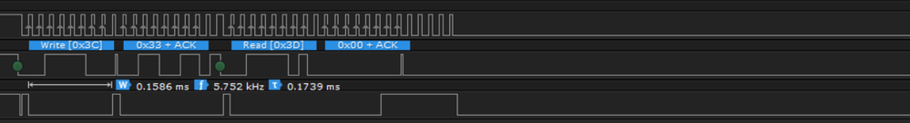

And just for reference, here's my oscilloscope screenshot with the Autostop feature enabled as well as the DBGEN = 1.
And the resume after capturing the breakpoint...

As for the DOZEN bit, I agree the description appears to be backwards.  I would expect that DOZEN = 1 means the DOZEN feature is enabled and DOZEN = 0 means the feature is disabled.  It may not actually be that way in silicon though.  Will have to do some more investigating. I do see that the DOZEN bit is supposed to apply to both STOP and WAIT modes.  So that is one thing to keep in mind.

Yes, you have seen the same behavior as myself when working with the debugger. DBGEN set to 0 means that the LPI2C sends a stop condition after the address. With DBGEN set to '1' the LPI2C freezes and so it continues correctly when the core operates again.
I don't understand the actual meaning of DBGEN since I would expect it to freeze with '0' set but this behavior has been confirmed by both of us and so it shows that it is not possible to use DGBEN at '0' but it is possible with DBGEN at '1' - that is the only option to allow LPI2C to operate correctly. Whether this a bug or not is another question but it is obviously the only possibility to actually work.

1. DBGEN state has no effect when the processor is not connected to the debugger/paused.
2. DBGEN has an effect when paused by the debugger and only DBGEN = '1' allows operation without the LPI2C sending an incorrect stop bit. WORKAROUND: Always set DBGEN to '1' and there are no issues.
3. DOZEN = 1 means that the LPI2C runs as normal in both WAIT and STOP modes.
4. DOZEN = 0 means that the LPI2C runs as normal in WAIT mode but stops in STOP mode. This is not as detailed in the user's manual, where it is states that it also stops in WAIT mode. The polarity is also inverted in the user's manual.

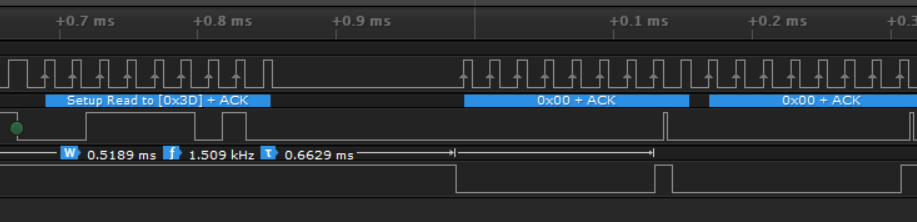

6. This is the recording showing 0.5ms pause after writing the START + slave write address
As can be seen, the delay doesn't affect operation - there is a following STOP and START (rather than repeated start) due to the firmware slowness, but this is correct.
7. This is the recording of the same with AUTOSTOP enabled.
The slowness of the firmware causes the LPI2C to automatically send the STOP condition. This is premature for correct behavior but is the fault of the slow firmware for using a mode that it can't keep up with. Therefore OK.

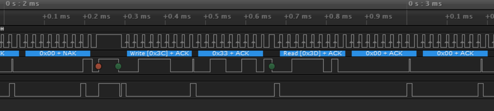

8. This is a normal read reference (just start of multi-byte read)
and the effect of a pause of 0.5ms.
The LPI2C waits correctly.
9. This is the effect of using AUTOSTOP and a pause in the read.
Note that now the LPI2C module sets the SCLK line high but the SDA line stays low forever.
This never recovers! NEVER start a read with AUTOSTOP set !!!!

I'll look into this.  One quick observation is that I think your misunderstanding the DBGEN values.  DBGEN = 0 means the LPI2C will NOT run in debug.  DBGEN = 1 means the LPI2C WILL run in debug.
I'll have to put some test code back together to look into the other aspect of your question.

I don't remember whether I actually used '1' or '0' for DBGEN.

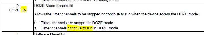

The DOZEN is in fact what causes some confusion (possibly I mixed them up) since its polarity is sort of inverted:
Comparison with the control in LPIT in the same cip:
In any case, the debug enable is not really the issue, but instead the fact that the LPI2C ends a STOP even though this is not commanded/programmed....
Mark

By the way, concerning the DOZEN:
When I program this to be "disabled" [set to '1'] and use WAIT mode it doesn't change behavior - it always runs - as shown by this recording:
The third line is '1' when the processor is in RUN and '0' when in WAIT mode (one sees that each I2C Rx interrupt wakes the processor for a short time).
When the DOZEN is set to '0' the behavior is identical.
If however the STOP mode is used instead of WAIT mode the LPI2C stops operating in STOP mode when DOZEN is '0'  and keeps operating when DOZEN is '1' (in STOP mode).
This is the compliment to the description of the DOZEN bit, which suggests a manual error in this case.
Note that when I did such tests on the LPIT it matched with the polarity in the user's manual but it also stops in WAIT mode. That means that DOZE mode includes WAIT for the LPIT but not for the LPI2C. Is this is what is expected??
