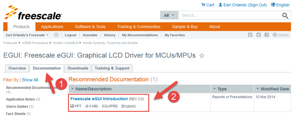

Hello Ankur,
The eGUI is a free lightweight graphic driver for Kinetis, Coldfire, HCS08 and HCS12 MCUs. It includes since the low level drivers support to an API to build your graphic objects. It runs either in baremetal or in a RTOS.
I recommend you to take a look into the introductory document that can be downloaded in the eGUI site www.freescale.com/egui.
Please let me know if this information is useful for you.
Earl.
