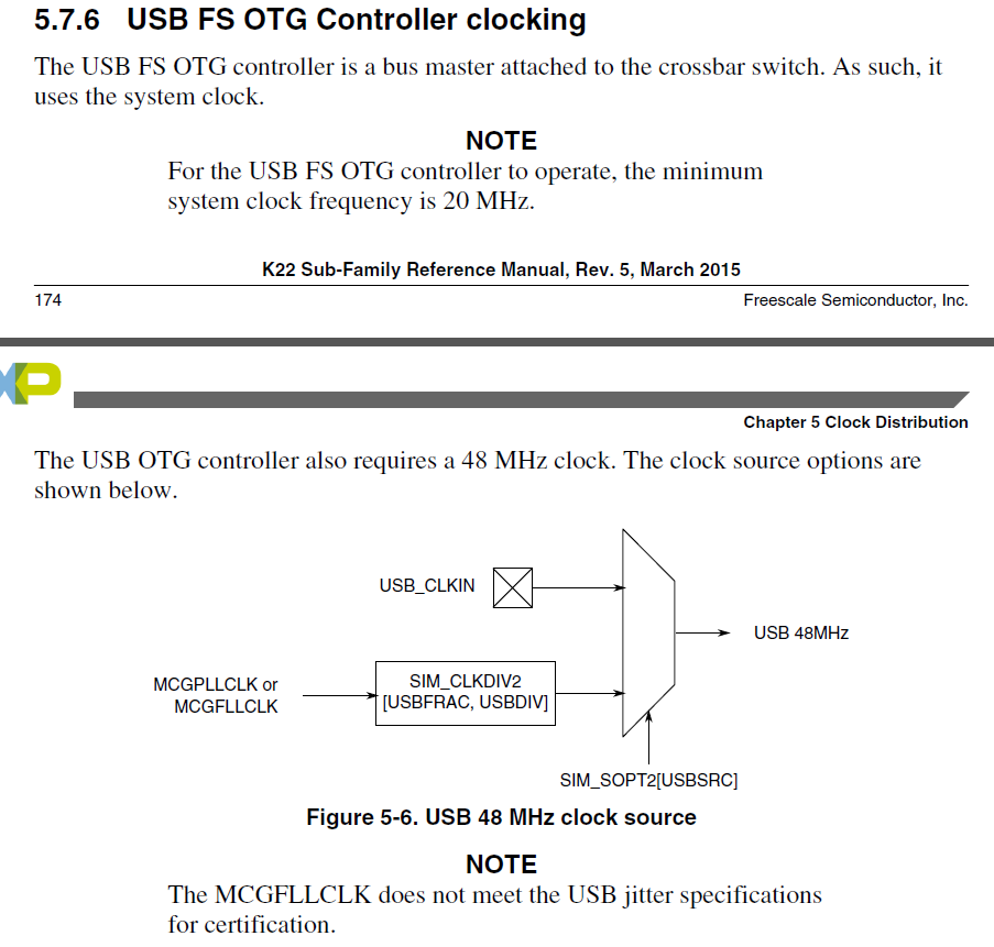

1. Can I use a 16mhz crystal to get 48mhz for core and usb?. 8mhz crystals usually have a big encapsulate.

I thougt so: so we have changed to K22 that has flexbus. I still have the doubt about the crystal: can I use 16Mhz to get 48Mhz for USB?

Of course, you can have the K22 run at 48mhz although the K22 can run at 120MHz at most so that you can save power. In the case, you can set the PLL input reference clock frequency in 2mHz by setting the PRDIV as 7(PLL input reference clock frequency=16/8=2MHz), set the VDIV as 24, the PLL output frequency is 2MHz*24=48MHz. You can use the 48MHz for both core/system and the USB modules.

I suppose you use K22 which can run in 120Mhz for example, you can select the MK22FX512AVMC12. If you use 16MHz crystal which is connected to EXTAL0/XTAL0 pins, I think it is okay to generate 48MHz clock signal for usb module.
Assume you use PLL to get 120MHz clock signal, there is a register SIM_CLKDIV2, which can divide the 120MHz to output 48mhz signal with the configuration SIM_CLKDIV2=0x09.
USB clock frequency=(2/5)*120MHz=48MHz. It is recommended that you use PLL to get the 120mhz clock signal for the core/system/bus/flash especially USB, the PLL can output clock signal with low jitter.
BTW, the PLL input reference clock frequency is 2~4mhz, you can use PLL internal divider to get 2Mhz clock signal as the PLL reference clock signal, use PLL to multiply it to 120mhz.
