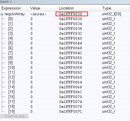

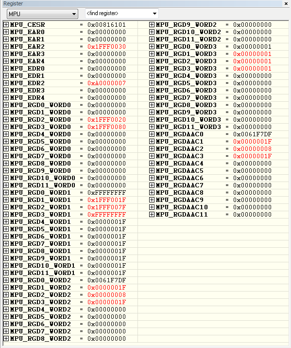

Customer could check below MPU register value during KSDK MPU demo execution:
The demo set the SRAM range [0x1FFF0020~0x1FFF007F] with supervisor mode read and execute allowed, but no write and user mode R/W/X no permitted.
That's why when the code want to write new value to related SRAM range will generate the bus fault.
        /* Cannot write here, bus fault occur. */
        regionArray[g_count] = g_count;
The regionArray[] located at above SRAM range as below variable window shows:
Wish it helps.
Ma Hui

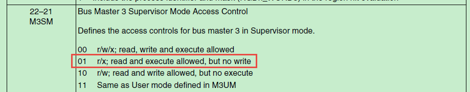

Hi Murat,
The MPU module in K8x product with below relationship with ARM Cortex M4 core:
SuperVisor = ARM Cortex M Privileged
User Mode = ARM Cortex M Unprivileged
For the MPU demo code located in Flash memory, that doesn't affect the code execution whatever ARM Cortex M4 core in Privileged mode or Unprivileged mode.
The demo shows the SRAM range was protected only with supervisor mode read and execute allowed, the user mode without read/write/execute right.
That SRAM range doesn't writable even core in privileged mode (supervisor mode), for the MPU_RGD2_WORD2 [M0SM] bits is 0b01:
The bus fault will happen, for there with operation to write new value to protected SRAM range.
