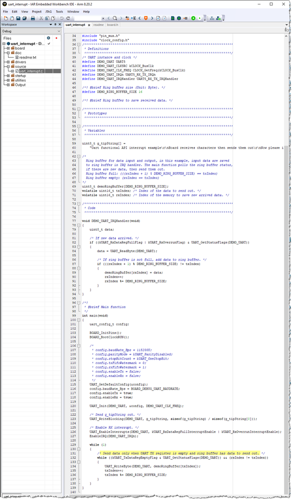

krunalpatel
Hi Robin,
Thanks for the reply.
I am using the same SDK Example ( See Attached File ), and even the your example is same as mine. Your attached example is Loopback one, so in that case you will never faced any issue of data losses, but here If I am writing 10 bytes of data into UART5 from HOST device ( Here It is Hyper Terminal ) without any delay, I'm facing an issue while receiving the UART data, i am getting only 2 bytes of data out of 10 bytes.
If I am writing data byte by byte with some delay between two consecutive bytes I am able to receive correct data.
If you have any serial communication example between  HOST Device - K60 Module, share it
Thnaks Again

Robin_Shen
Sorry for my late reply!
Have you try to receive data into demoRingBuffer[]  in UART5_RX_TX_IRQHandler and send out after 10 bytes received in main?
You can find that example will check the UART state before send data: Send data only when UART TX register is empty and ring buffer has data to send out.
Or try to test:
void UART5_RX_TX_IRQHandler(void)
      if ((kUART_RxDataRegFullFlag | kUART_RxOverrunFlag) & UART_GetStatusFlags(UART5))
            uint8_t data = UART_ReadByte(UART5);
                     UART_WriteByte(DEMO_UART, data);
Robin
