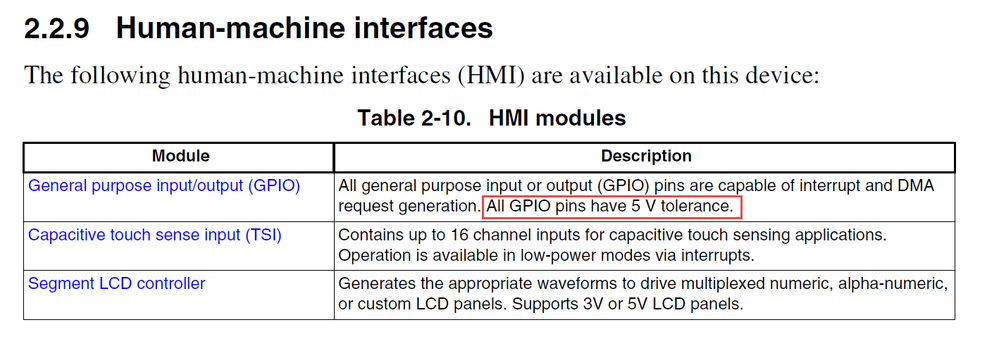

Regarding the issue of 5V tolerance.  Thanks for your comments.  Is there any K40 documentation regarding it, to confirm your reply?  Perhaps your point is that the newer manuals for the other K family members are more complete, and the K40 is similar.  Per another reply, the following statement is in the K40 reference manual in Table 2-10 "HMI Modules":
"All general purpose input or output (GPIO) pins are capable of interrupt and DMA request generation. All GPIO pins have 5 V tolerance."   There is no statement in the K40 manual (that I could find at least) that "Open drain outputs must be pulled to VDD" (per the page you copied from the K64 manual).  What is the point of 5V tolerant pins if they must be pulled to VDD, and VDD must be 3.6V or less?  Perhaps the point is just for use as inputs up to 5V(?).  Any additional clarification you could provide would be appreciated.
