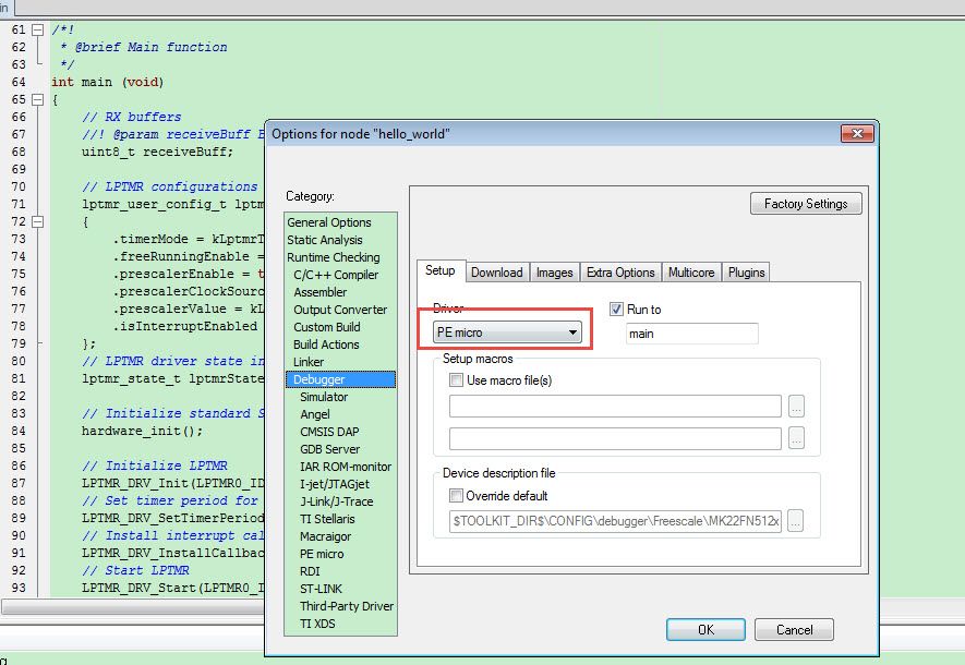

I'm trying now for hours to get the P&E Multilink Universal FX to work within IAR for ARM 7.40.
If I use JTAG mode, I always get the message 'Failed to initialize PEMicro interface dll. Session aborted!'. Same same with the onboard OpenSDA-Debugger of the FRDM-K22F board.
Using SWD mode the debugging mode starts, but I have no control. The devices runs automatically and if setting breakpoints I get 'Failed to set breakpoint: Target busy.'
But within Kinetis Design Studio both of the debuggers are working... Has anyone of you a hint, how to get the combination IAR/PEMicro to work?

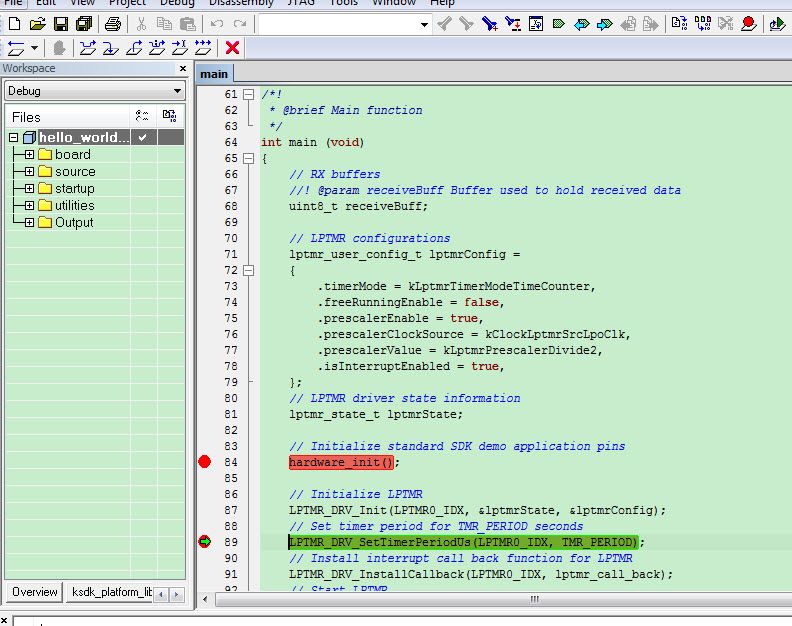

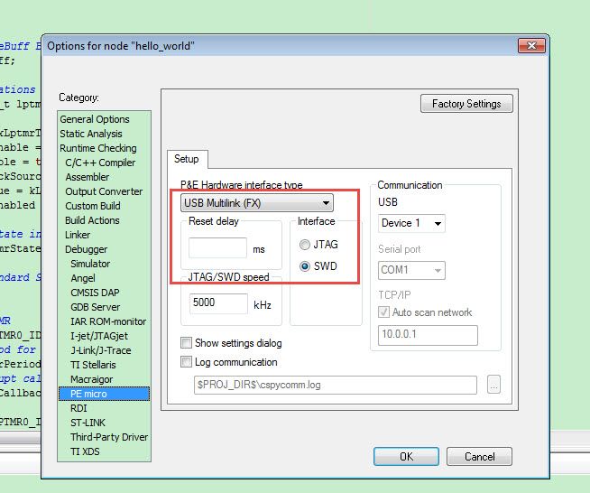

     If you use the IAR7.4 and the PE multilink univeral on the FRDM-K22 board, you should use the SWD interface, please configure your IAR like this:
But if you choose the OPENSDA in the FRDM-K22 bord, you should choose the CMSIS-DAP, not the PE opensda, because the debugger on this board is OPENSDA V2.1, it is the CMSIS-DAP.
Wish it helps you!

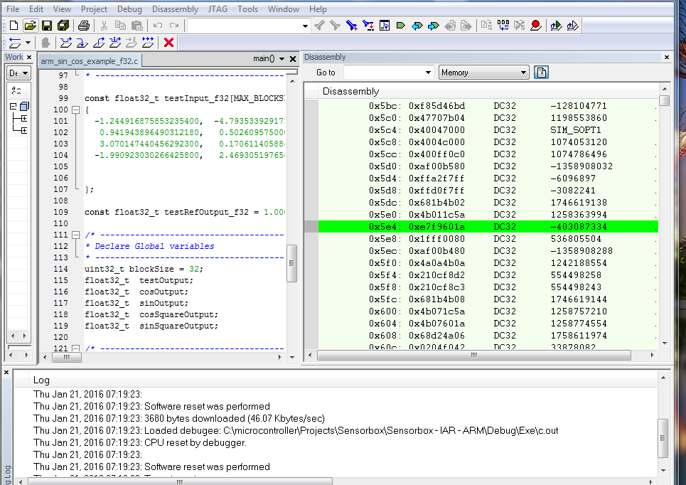

unfortunately I tried all variants and your tip doesn't help at the moment. If I choose PEMicro USB Multilink (FX) with SWD, the app is transfered to the target but starts automatically.
If I break the session it shows like this:
It seems that the debugger can't control the target...
If I choose CMSIS-DAP I get the message: 'Fatal error: Probe not found     Session aborted'
I don't know where to look next to fix this problem...

In the meantime I found a combination thats works:
I was flashing the Freedom-Board-Debugger with the J-Link firmware and with that everything works fine!
Now I think I have some issues with drivers, firmware etc of the PEmicro debugger. Will let you know once I found the bug!
